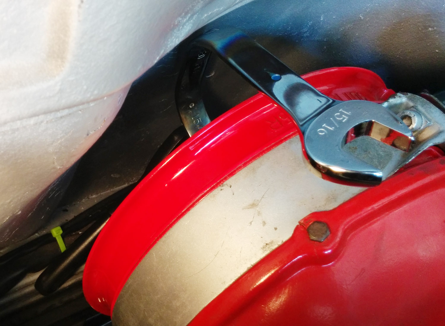

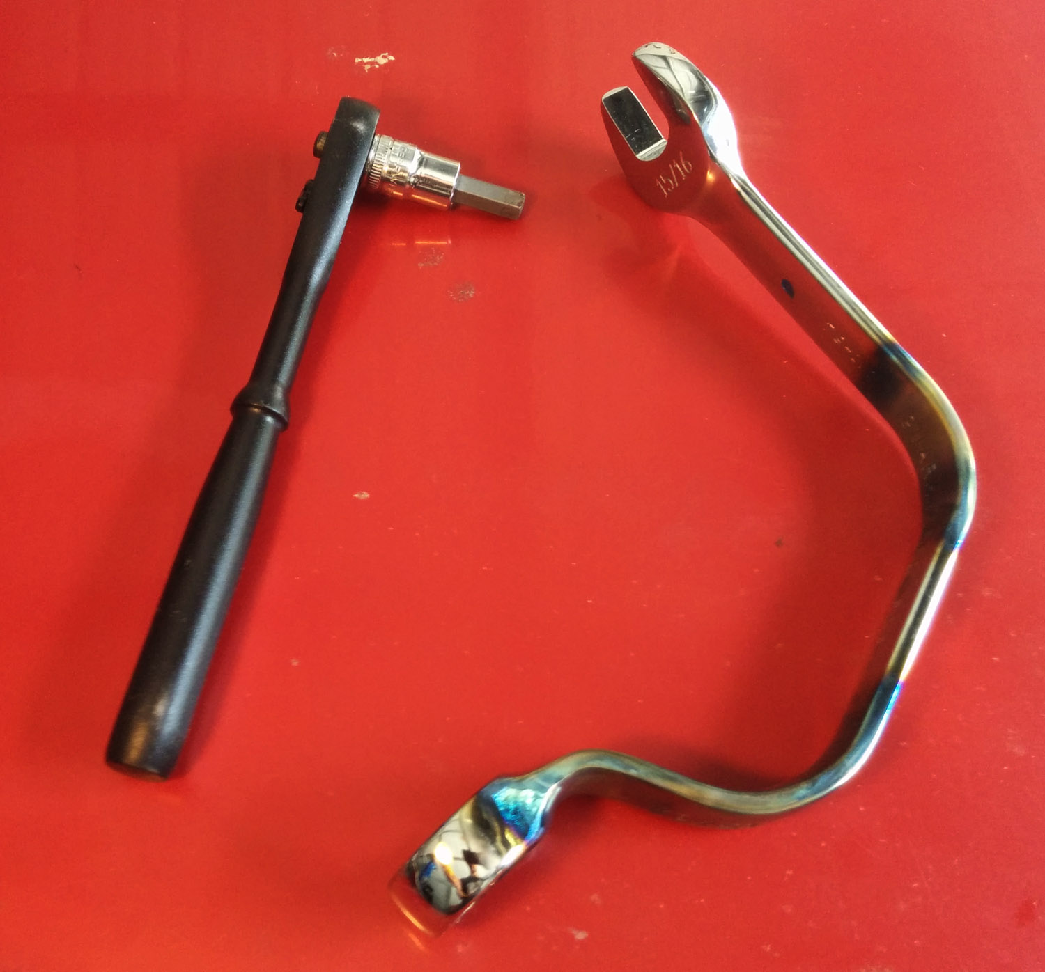

Don't need a hole to replace the belt. Here's my trick!

QUOTE(patssle @ Dec 12 2014, 01:27 PM) *
Wouldn't work for me, I'll have to get a different pulley and I don't know what the hex key is for...
