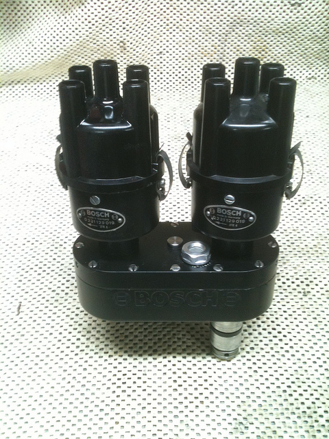

Okay, I got kind of lost/sidetracked while reading this thread, especially in regarding to the dual spark distributors.
But there is a really cool thread over at the Samba where someone created a dual dizzy setup for a Type 1 - I didn't even know this was possible!
(IMG:http://www.914world.com/bbs2/uploads_offsite/images.thesamba.com-13527-1365724910.1.jpg)
Video of it running here:
http://www.thesamba.com/vw/forum/viewtopic...sc&start=60

QUOTE(ThePaintedMan @ Apr 11 2013, 04:01 PM) *
Hey George,
If you google "964 distributor belt" you will see how similar in design that one in the picture above is to how the factory did it on the 3.6 motors. I had to replace the belt in mine when I 1st bought the car.
