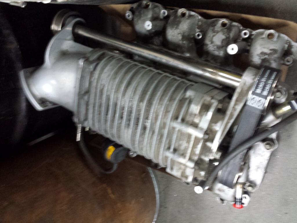

Don't forget to service the bearings, shafts and drain/ refill with oil at 100,000mi. intervals. More maint. on the supercharger is the reason I prefer turbos over superchargers. Magnacharger going in for service, shown here Attached Image
Marty
