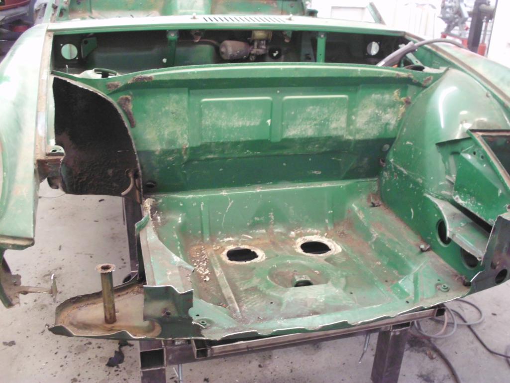

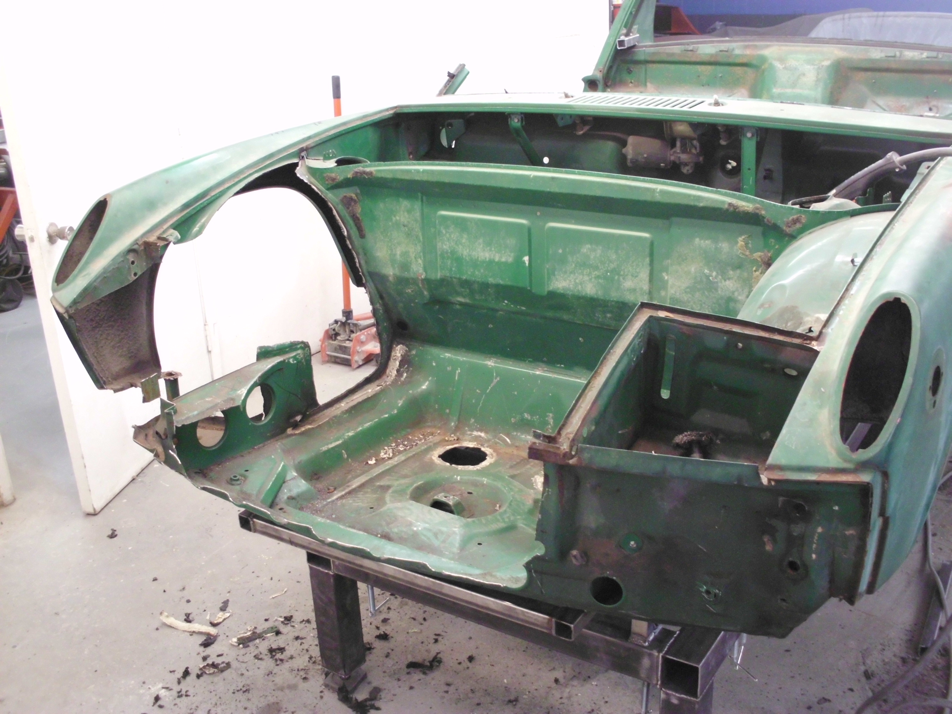

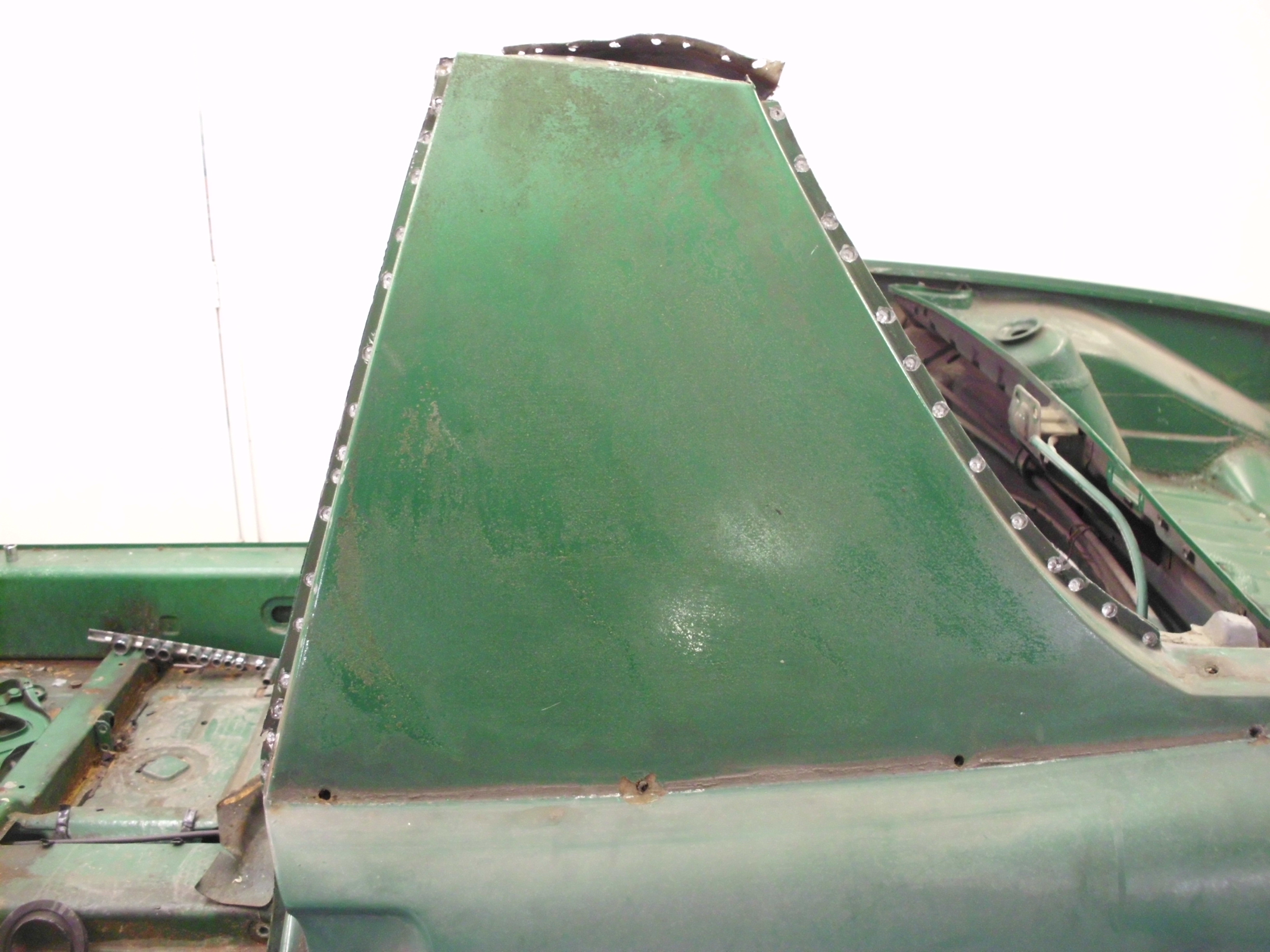

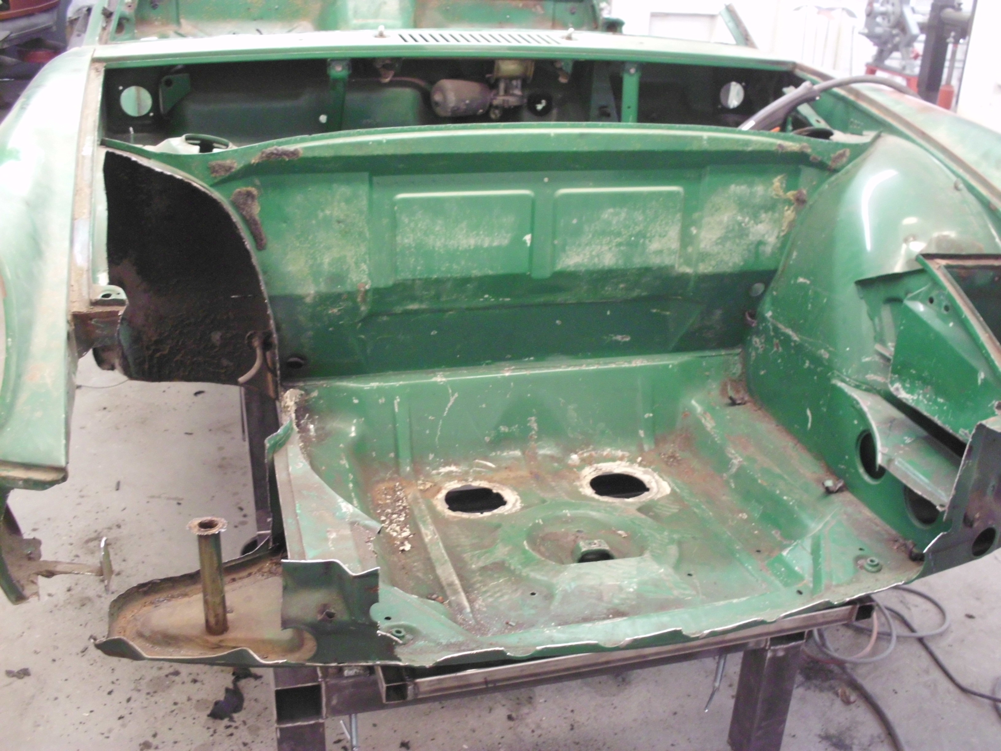

914350   Spent today trimming the panels off of the car and...   Oct 25 2014, 07:35 PM
914350   The inner Roll Bar structure is in great condition...   Oct 25 2014, 07:38 PM
914350   More pics.   Oct 25 2014, 07:44 PM

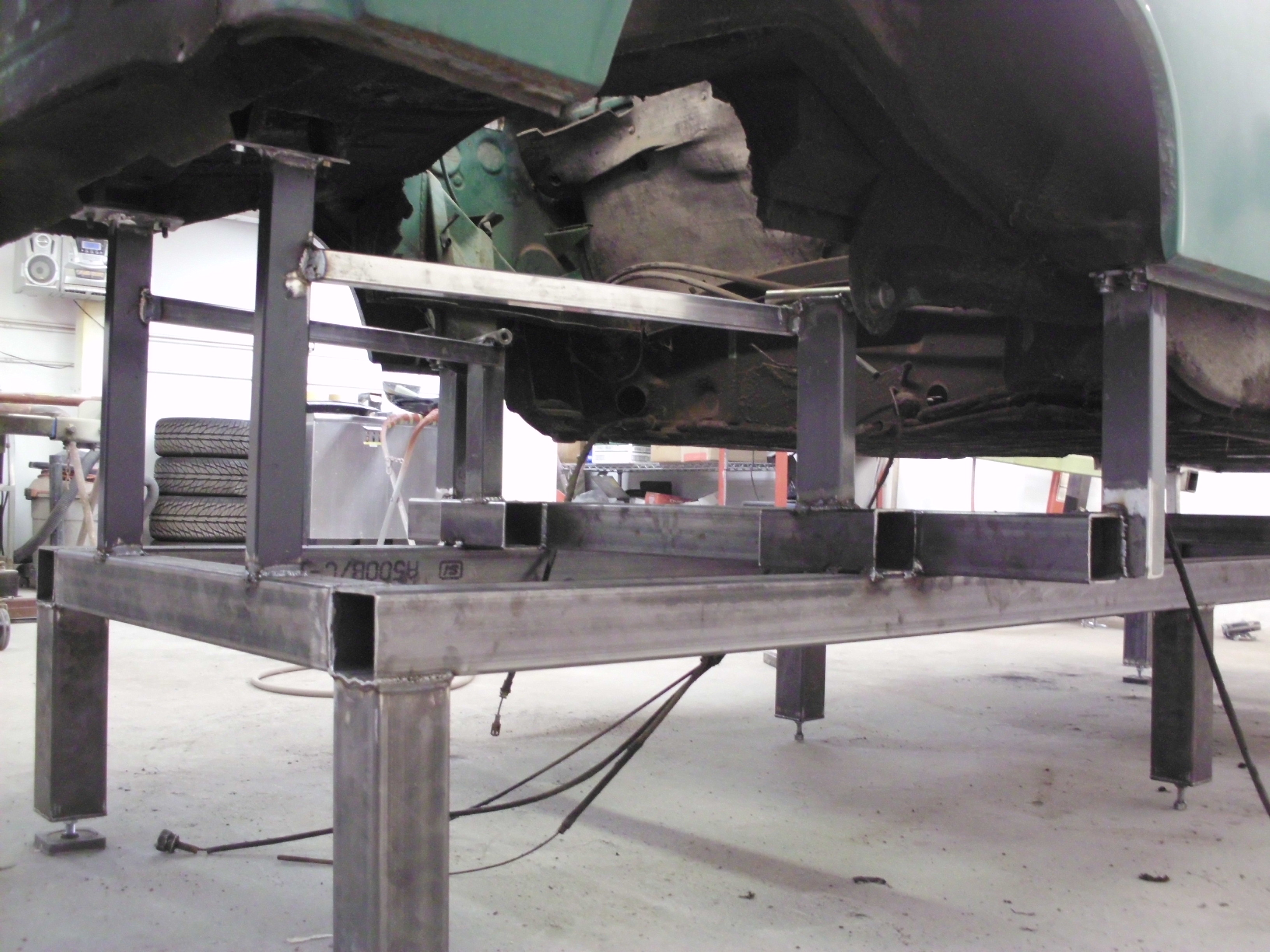

914350   Picked up metal to build Frame Fixture.   Nov 1 2014, 12:26 AM

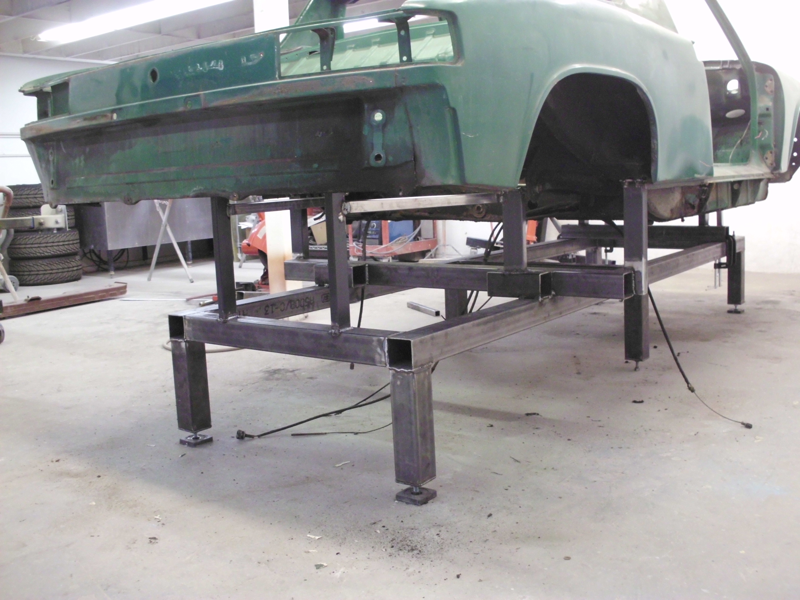

914350   Progress on the fixture.   Nov 28 2014, 10:29 PM
914350   More pics.   Nov 28 2014, 10:32 PM
914350   More pics.   Nov 28 2014, 10:36 PM
914350   This fixture will be removable from the table so t...   Nov 28 2014, 10:46 PM
914350   Rear mounting points.   Nov 30 2014, 08:04 AM
914350   More pics.   Nov 30 2014, 08:06 AM
914350   I intalled an alignment dowl to relocate the front...   Nov 30 2014, 08:12 AM

914350   I got some more done on the fixture today. the fr...   Dec 7 2014, 05:37 PM
914350   The rear of the fixture is almost done and I hope ...   Dec 7 2014, 05:49 PM
914350   More pics.   Dec 7 2014, 05:51 PM
914350   More pics.   Dec 7 2014, 05:53 PM
banananose914   Bad, bad ass!   Dec 7 2014, 11:07 PM
914350   Finished the fixture today and started cutting apa...   Dec 14 2014, 12:30 AM

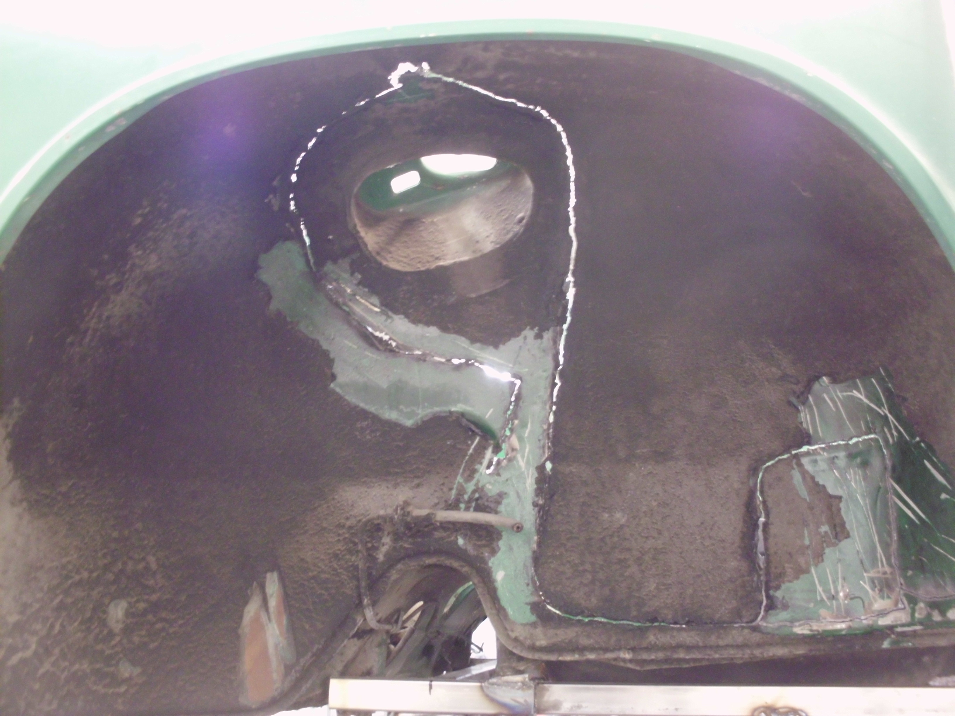

914350   More cutting, drilling, scraping on the donor car.   Dec 22 2014, 10:18 PM
914350   More pics.   Dec 22 2014, 10:21 PM
914350   More pics.   Dec 22 2014, 10:22 PM
