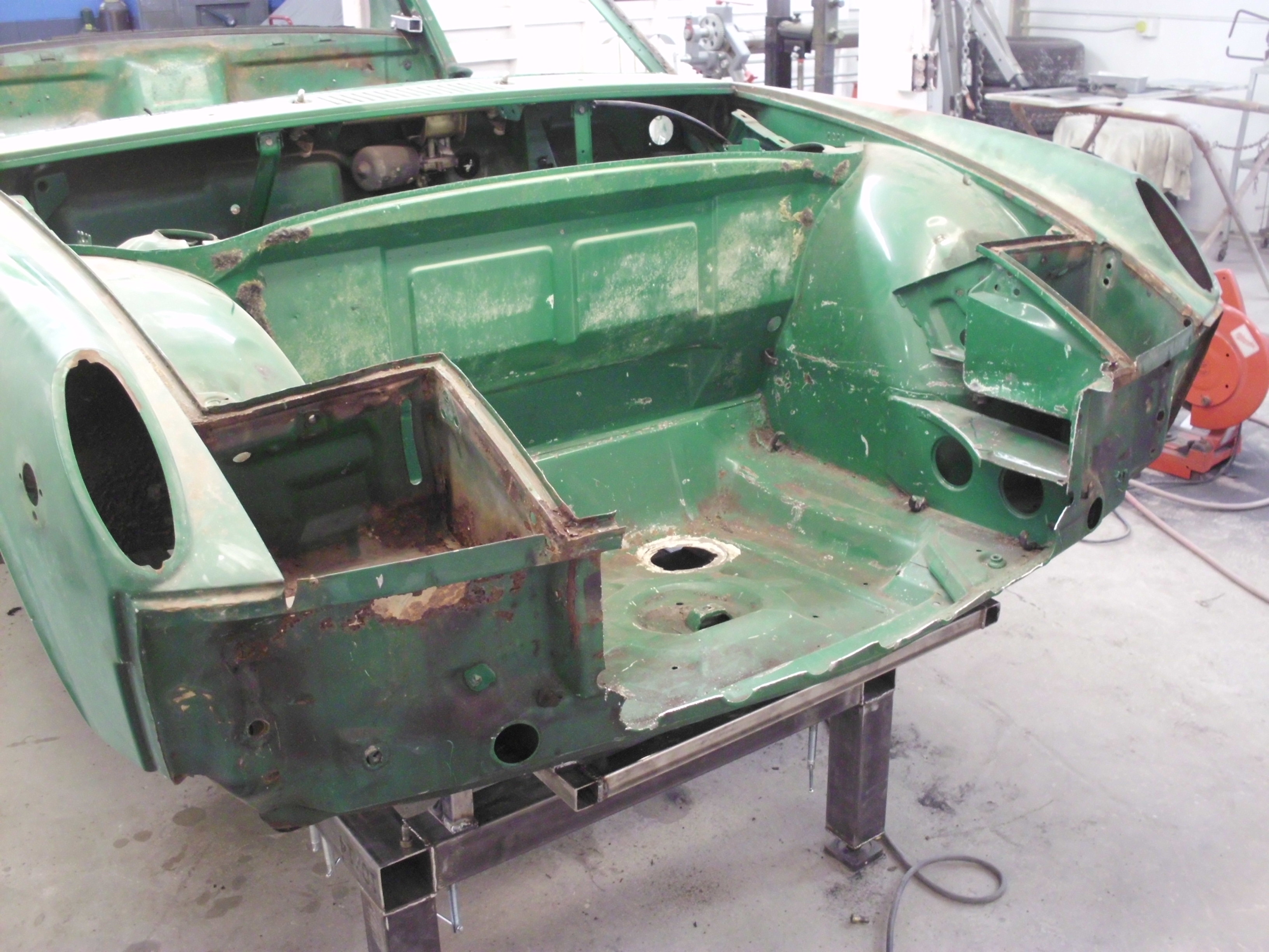

914350   Finished the fixture today and started cutting apa...   Dec 14 2014, 12:30 AM
914350   More pics.   Dec 14 2014, 12:33 AM
914350   More Pics.   Dec 14 2014, 12:37 AM
914350   More pics.   Dec 14 2014, 12:39 AM
914350   More pics.   Dec 14 2014, 12:40 AM

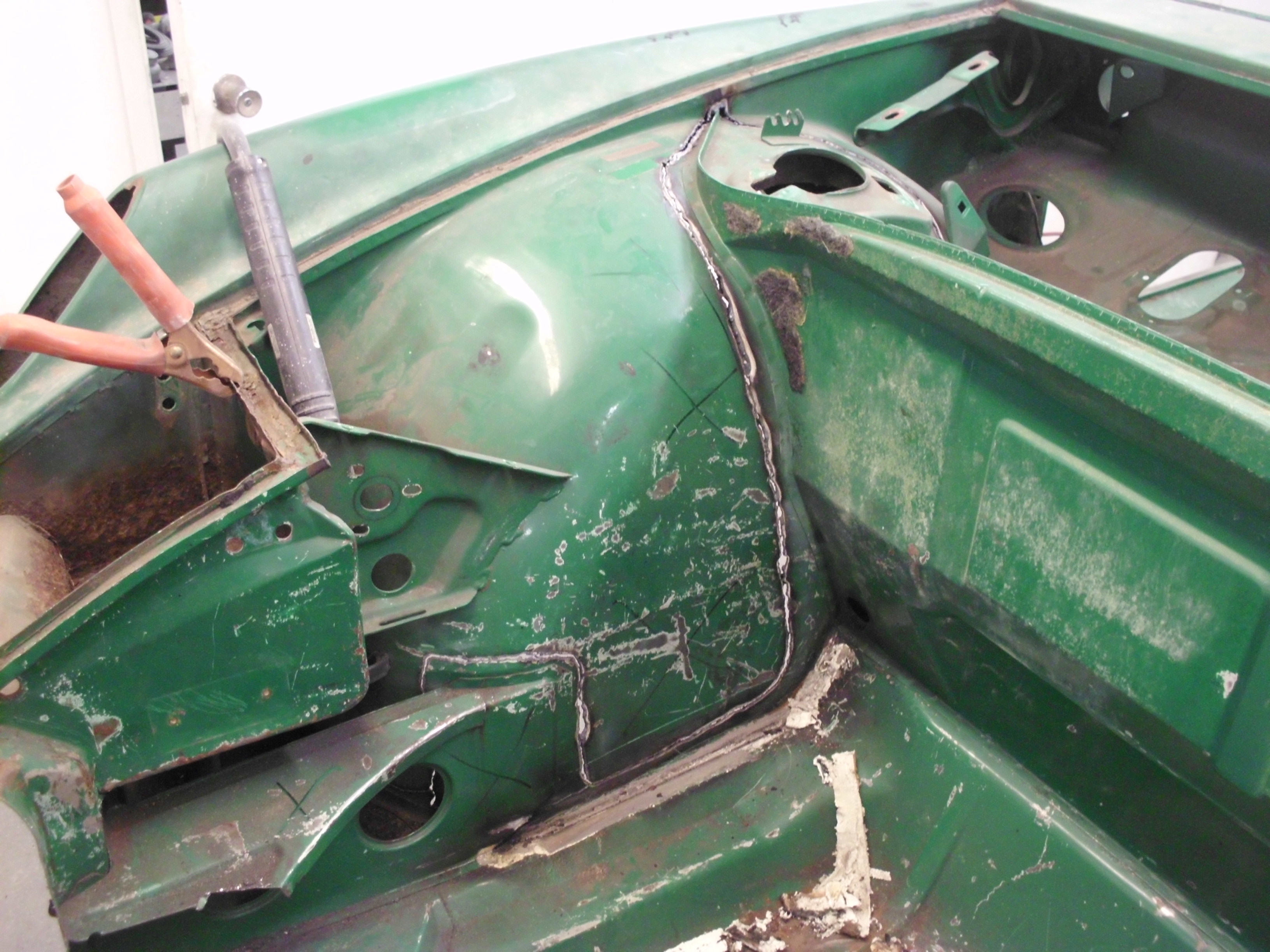

914350   More cutting, drilling, scraping on the donor car.   Dec 22 2014, 10:18 PM
914350   More pics.   Dec 22 2014, 10:21 PM
914350   More pics.   Dec 22 2014, 10:22 PM

914350   Got the Donor car all cut up and off the fixture, ...   Jan 2 2015, 10:14 PM
914350   More.   Jan 2 2015, 10:15 PM
914350   More.   Jan 2 2015, 10:17 PM
914350   I used the rotissorie to lift the car onto the fix...   Jan 2 2015, 10:23 PM
914350   More.   Jan 2 2015, 10:25 PM
914350   more.   Jan 2 2015, 10:27 PM
914350   More.   Jan 2 2015, 10:27 PM
914350   As expected, the car is bent but no worries there ...   Jan 2 2015, 10:38 PM

914350   More work this week.   Jan 12 2015, 11:41 AM
914350   Trimming edges.   Jan 12 2015, 11:44 AM
914350   Jim, I promise I will stop cutting before there is...   Jan 12 2015, 11:48 AM
914350   Yikes!   Jan 12 2015, 11:51 AM
