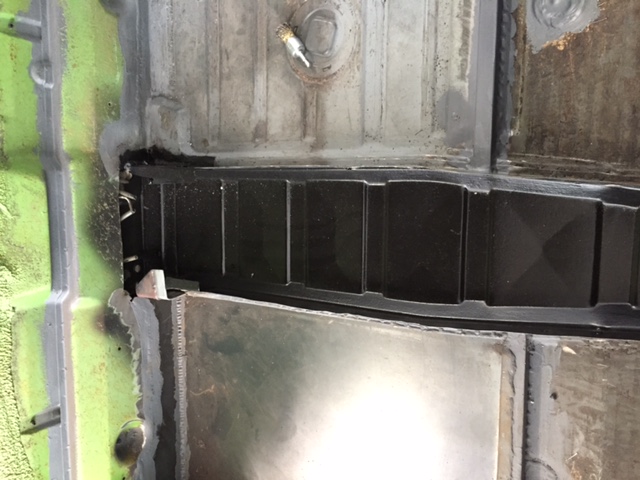

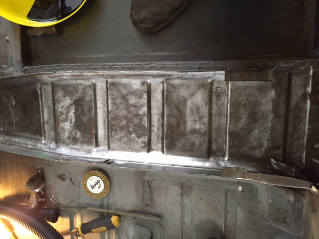

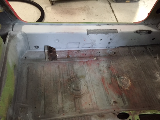

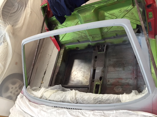

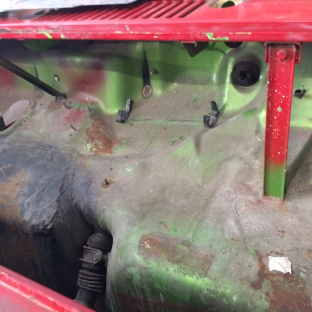

been a few weeks since the last update - but have been busily beavering away on small stuff - but non the less, stuff that needs to be done ...
in no particular order ...
the PO welded the dashboard to the scuttle - you can see in the pics the weld marks - I have no idea why they would have done this, the 4 bolts across the top were in place & holding it down ... v odd ... must have been done when it was converted to RHD.
painful place to be able to get to as well, ended up getting a chisel & making a bit of a mess of the scuttle ... its out though now & have repaired the scuttle & pained it with epoxy rustkill in matt black. looks much better now :
had a weekend away with the lotus guys at a track about 650 kms from home ! great weekend with 65 other lotus' - a huge achievement for Australia given the lotus is not an overly popular car here ...
cleaned up the windscreen surround - removed all the black goop holding the screen in place, cleaned, sanded & gave it a couple of coats of primer to keep it in good condition. the bottom of the screen was good condition with only very minor pitting.
started installing the bracing kits & have the left hand side installed - went in easily enough - have the rest of it to do now (IMG:style_emoticons/default/smile.gif)
there was a lot of surface rust under the middle section, where the various pipes run, that was impossible to get at to clean up - so I cut the top off it, spent about 2 hours with a a few wire wheels & painted in matt black epoxy rustkill - looks good now (IMG:style_emoticons/default/smile.gif) will make up a few straps to weld in place to box the tunnel in place & will cover with a new sheet of steel & will bolt it in place with rivnuts to allow later access
also got the bottom of the firewall welded in on the right hand side- whats the best way to re-coat the inner part of the firewall - the void ?
cleaned & painted the various parts of the steering column - installed a new VW ignition switch & sourced a new ignition barrel - my car didn't come with a key - so managed to get a working barrel & key from a '73 and will send door locks & boot lock off to get serviced & re-key'd.
as a note of interest, and possibly common knowledge, but the '75 onwards ignition barrel cannot be re-keyed - however, the early barrel fits in the late steering column with no modifications.
picked up a wrx gearbox for cheap from ebay ($430 AUD) - have ordered a locking spline and made up a cover for the rear of the box from 5mm aluminium plate.
still not decided on the best option for driveshafts - not in a big rush to make the decision as am prob 8 months of needing to install a drivetrain ...
should be able to get a day or two of work in over the xmas period - would be great to get it to the point of being able to install a roll cage !
