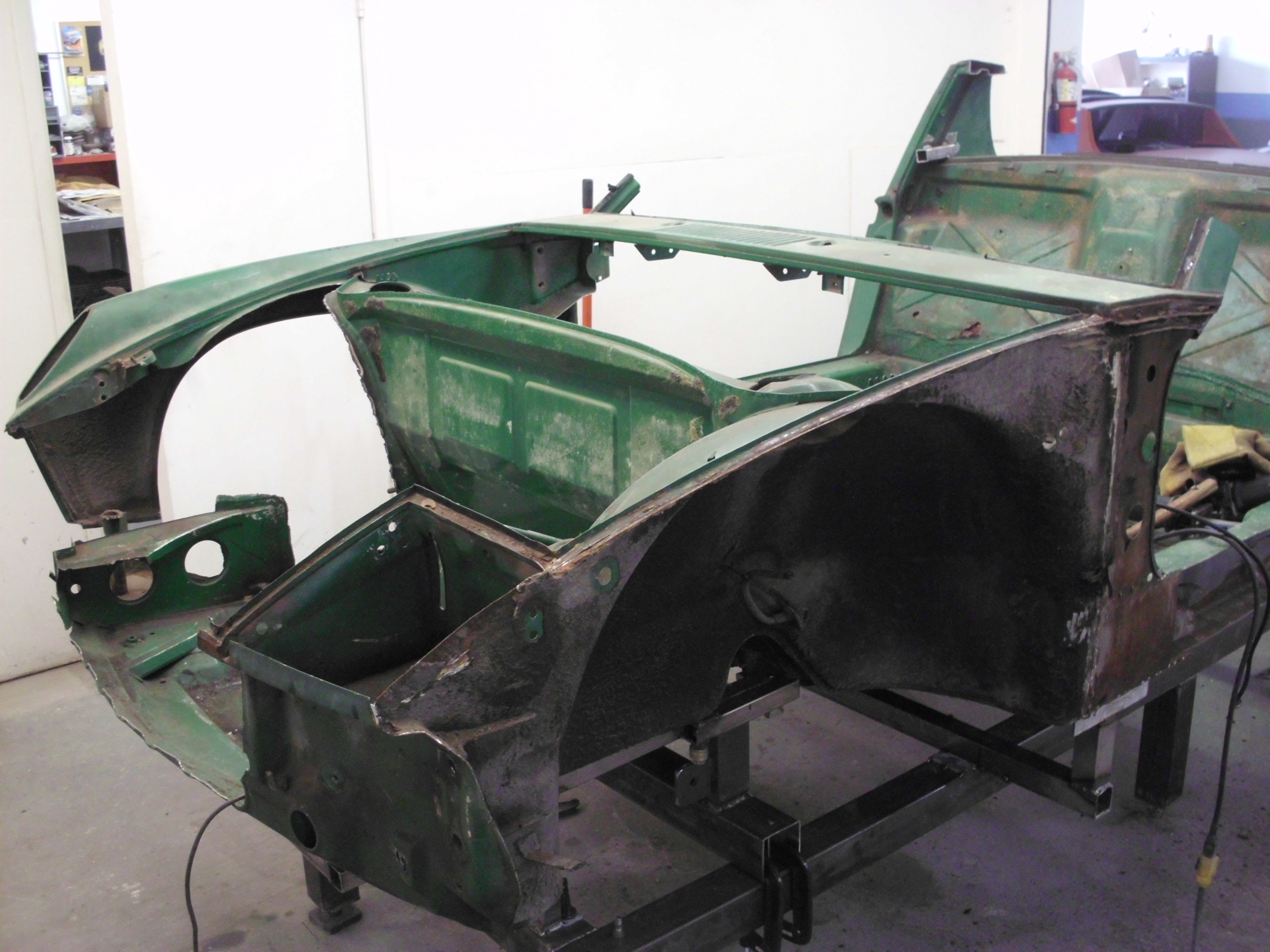

914350   More cutting, drilling, scraping on the donor car.   Dec 22 2014, 10:18 PM
914350   More pics.   Dec 22 2014, 10:21 PM
914350   More pics.   Dec 22 2014, 10:22 PM

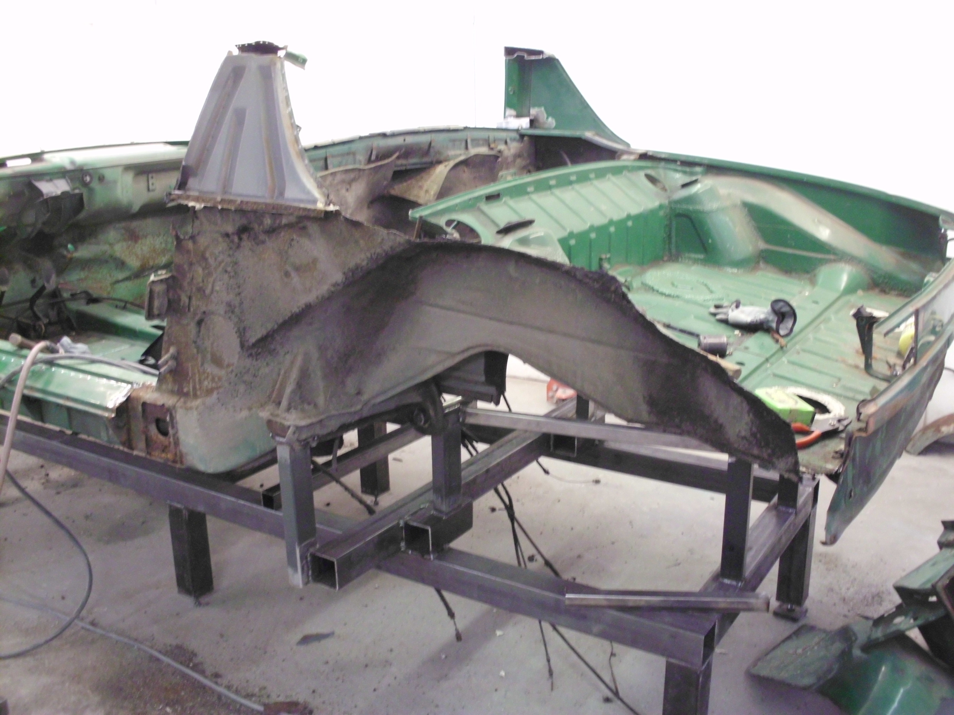

914350   Got the Donor car all cut up and off the fixture, ...   Jan 2 2015, 10:14 PM
914350   More.   Jan 2 2015, 10:15 PM
914350   More.   Jan 2 2015, 10:17 PM
914350   I used the rotissorie to lift the car onto the fix...   Jan 2 2015, 10:23 PM
914350   More.   Jan 2 2015, 10:25 PM
914350   more.   Jan 2 2015, 10:27 PM
914350   More.   Jan 2 2015, 10:27 PM
914350   As expected, the car is bent but no worries there ...   Jan 2 2015, 10:38 PM
