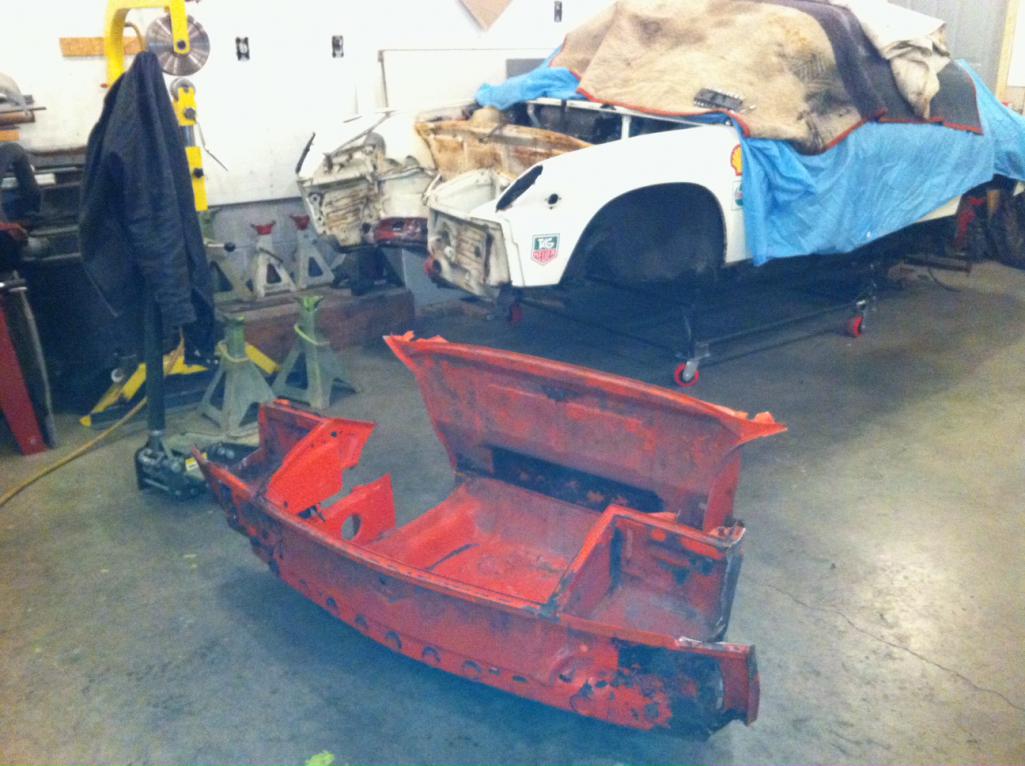

Hi all, I’m still a newbie here on world, I’ve made a few posts but have not yet formally introduced myself. My name is Kent and I have been restoring cars for over 20 years now. I did the reconstruction, body and paint on Andy’s (socalandy) 914-6. I immediately became hooked on 914,s and bought and built a 914 V8 conversion. I am starting a new restoration on another 914-6 so I will be posting pics of the progress as I go. The owner of this cars name is Jim and he has done a nice job of rounding up and restoring many of the parts thus far so this will no doubt be a nice car in the end. Andy (socalandy) posted a thread on this car a few months back and now it is in my shop and I’m ready to begin.

Oh yeah. I have seen that you dig in deep on these. It's a lot of work to get it them apart and still have something usable. It would be a lot easier if I had two to cut up. It's dificult to preserve both the fender and the cowl. It would be much quicker/easier to distroy the fender to get to the cowl and vice versa. I was able to get my plasma cutter in up under the fender near the cowl and knock the welds loose to get the fender off and didn't distroy the cowl and that's only after scraping out gobbs of seam sealer.
