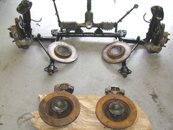

Here is a quick pic of the 911 stuff. Can anyone tell what year they might be from by this picture?
Mike

microsa   Here is a quick pic of the 911 stuff. Can anyone t...   Aug 27 2004, 05:08 PM
Cap'n Krusty   SC. The Cap'n   Aug 27 2004, 05:13 PM
Cap'n Krusty   OOPS! Sorry! Not SC, but somethong in th...   Aug 27 2004, 05:16 PM
microsa   Soooooo, will it work on the 914 or did we get sol...   Aug 27 2004, 05:20 PM
Jeroen   As far as I can tell, that's prolly '69 th...   Aug 27 2004, 05:21 PM
microsa   The rear stub axles and calipers are in the foregr...   Aug 27 2004, 05:23 PM
