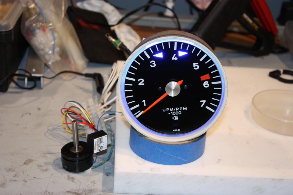

I have a couple DIY'er threads on how to integrate single or multicolor LED's inside each gauge can. I can also do it for you and include my custom controller which changes the color to red at a set RPM Just out of curiosity. Did you use an arduino for the tachometer? I built one that works on either the stock ignition (tach signal) or (easier) a cleaner signal from a Mallory unilite optical pickup. I used an interrupt driven frequency counter in the Arduino. Turns my tach bright blue as a shift light. (IMG:http://www.914world.com/bbs2/uploads_offsite/i366.photobucket.com-10819-1419881385.1.jpg) |
