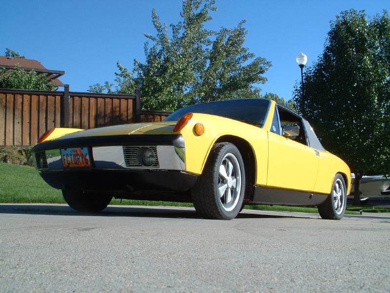

Well... after our little fuel pump fun today, the six is back. All it needs is a thorough clean up and a full tank of gas. Thanks for all the comments from those who followed along. Here's the last bit of the restoration thread... the grand finale:

Eric_Shea   Well... after our little fuel pump fun today, the ...   Aug 27 2004, 06:26 PM
Eric_Shea   more...   Aug 27 2004, 06:28 PM
Eric_Shea   nuther...   Aug 27 2004, 06:29 PM
Eric_Shea   guess who...   Aug 27 2004, 06:30 PM
Eric_Shea   canary yellow...   Aug 27 2004, 06:32 PM
Eric_Shea   The last shot mirrors the very first post in this ...   Aug 27 2004, 06:34 PM
