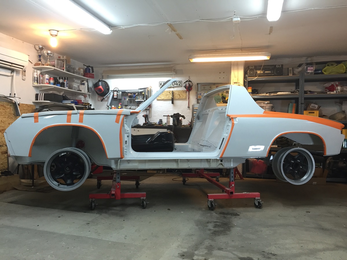

Happy new year!
Though I'm six months behind my original schedule it still feels pretty awsome having gotten this far.
