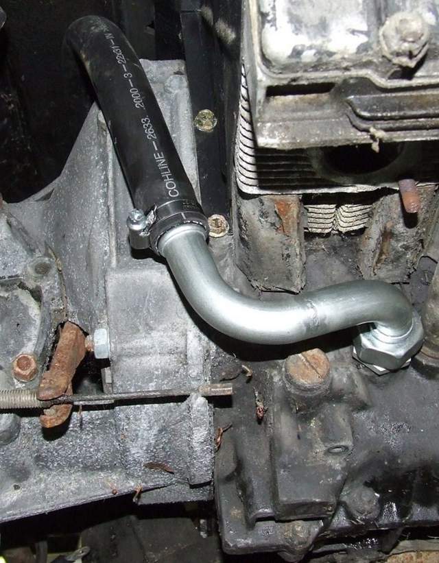

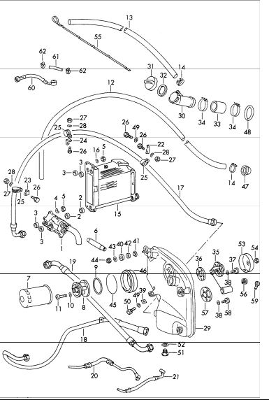

Mark...that is the one....the early SWB 911 68< used this "soft" line...it went up and over the tranny from the engine to the tank...here is a pic of where someone made one....it's #17 in the diagram.....that was used until the #18 version
I've dismantled a few early 911 that had them and various shop made versions and some out of AN fittings and SS hose....never tried to use one on a 914-6...not sure about the length of it to the 914-6 tank....should work just like on 911...keep away from HEs....
