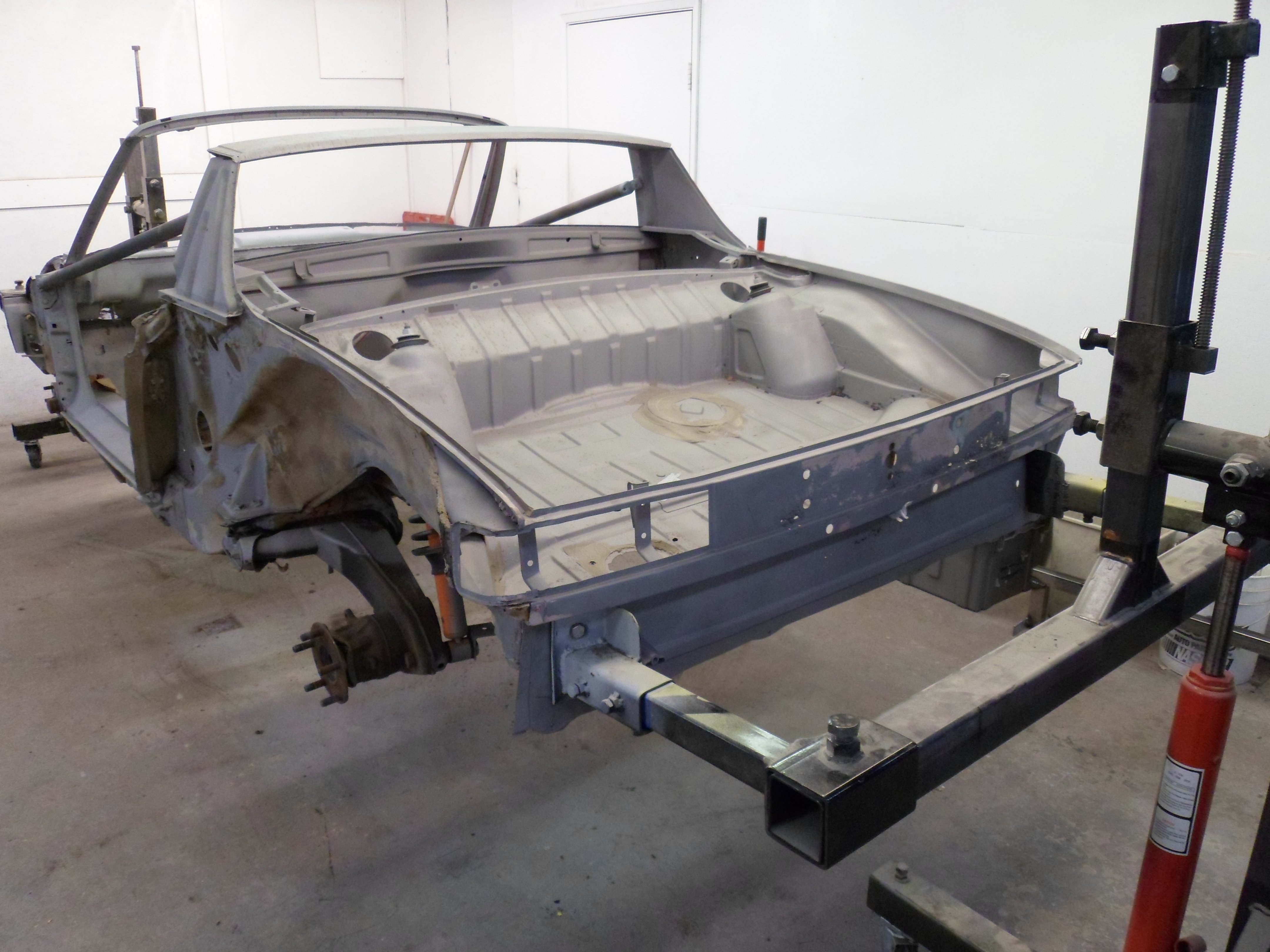

Hi all, I’m still a newbie here on world, I’ve made a few posts but have not yet formally introduced myself. My name is Kent and I have been restoring cars for over 20 years now. I did the reconstruction, body and paint on Andy’s (socalandy) 914-6. I immediately became hooked on 914,s and bought and built a 914 V8 conversion. I am starting a new restoration on another 914-6 so I will be posting pics of the progress as I go. The owner of this cars name is Jim and he has done a nice job of rounding up and restoring many of the parts thus far so this will no doubt be a nice car in the end. Andy (socalandy) posted a thread on this car a few months back and now it is in my shop and I’m ready to begin.

I used the rotissorie to lift the car onto the fixture. BTW Andy came by today and helped out...Thanks Man!

914350   Got the Donor car all cut up and off the fixture, ...   Jan 2 2015, 10:14 PM
914350   More.   Jan 2 2015, 10:15 PM
914350   More.   Jan 2 2015, 10:17 PM
914350   I used the rotissorie to lift the car onto the fix...   Jan 2 2015, 10:23 PM
914350   More.   Jan 2 2015, 10:25 PM
914350   more.   Jan 2 2015, 10:27 PM
914350   More.   Jan 2 2015, 10:27 PM
914350   As expected, the car is bent but no worries there ...   Jan 2 2015, 10:38 PM
