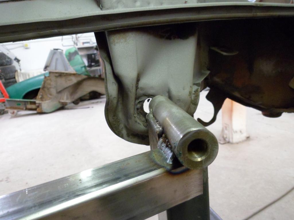

As expected, the car is bent but no worries there will be no signs of an accident when completed. It's interesting how you can see exactly how off it is once on the fixture. The front is twisted and sitting high on the drivers side and the entire front of the car is still pushed over to the right and shoved back. The car was "repaired" after the accident but not properly. this pic shows the damage to the rear suspension console.
