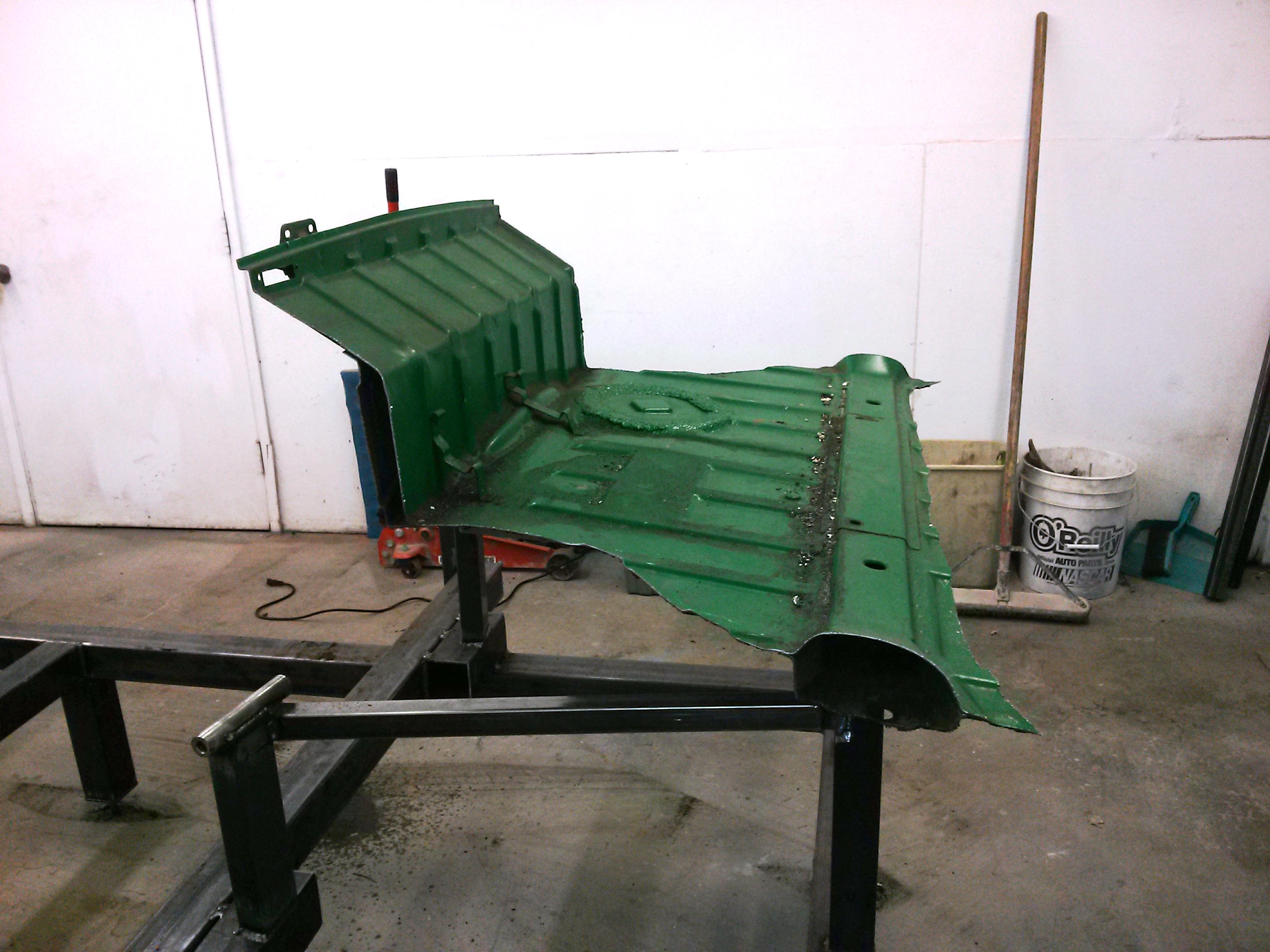

914350   I got some more done on the fixture today. the fr...   Dec 7 2014, 05:37 PM
914350   The rear of the fixture is almost done and I hope ...   Dec 7 2014, 05:49 PM
914350   More pics.   Dec 7 2014, 05:51 PM
914350   More pics.   Dec 7 2014, 05:53 PM
banananose914   Bad, bad ass!   Dec 7 2014, 11:07 PM
914350   Finished the fixture today and started cutting apa...   Dec 14 2014, 12:30 AM
914350   More pics.   Dec 14 2014, 12:33 AM
914350   More Pics.   Dec 14 2014, 12:37 AM
914350   More pics.   Dec 14 2014, 12:39 AM
914350   More pics.   Dec 14 2014, 12:40 AM
