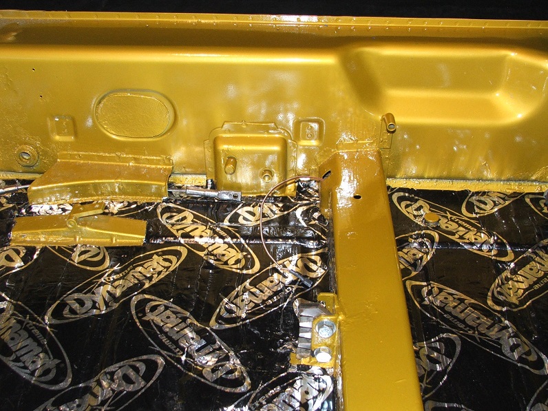

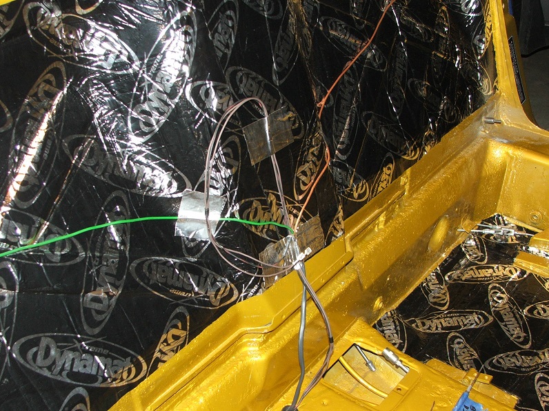

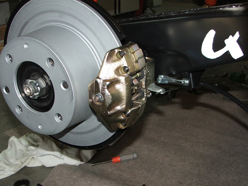

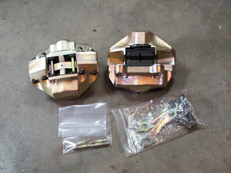

I got some goodies from PMB yesterday, and I installed the rears today.

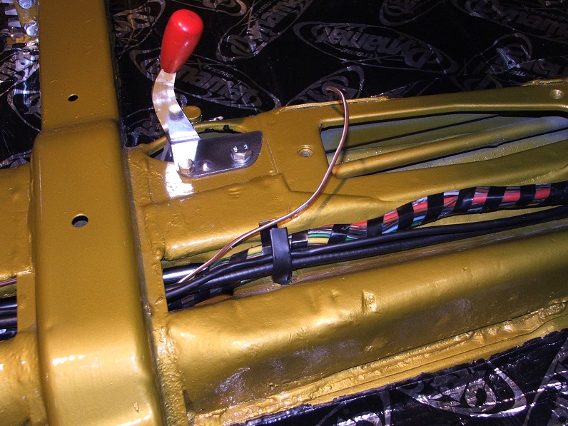

I also installed the rear defrost harness. While doing so, I found a brown and white wire that I'm not sure where it should go. It's a short one that comes out of the harness next to the green and white wire that connects to the heater lever. At first I thought it was for the e-brake switch, but it is too short, and I ran what I hoped was the brake wire already. Any ideas?
E-brake wire.
Rear defrost wires run.

puffinator   What does the "4" painted on the trai...   Jan 8 2015, 07:12 AM
rangrbob   What does the "4" painted on the tra...   Jan 8 2015, 08:41 AM
Jeff Bowlsby   Single brown/white wire in that area should be the...   Jan 7 2015, 11:03 PM
