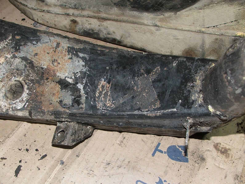

What does the "4" painted on the trailing arm represent?

QUOTE(puffinator @ Jan 8 2015, 06:12 AM) *
It represents the factory assembly line markings.
