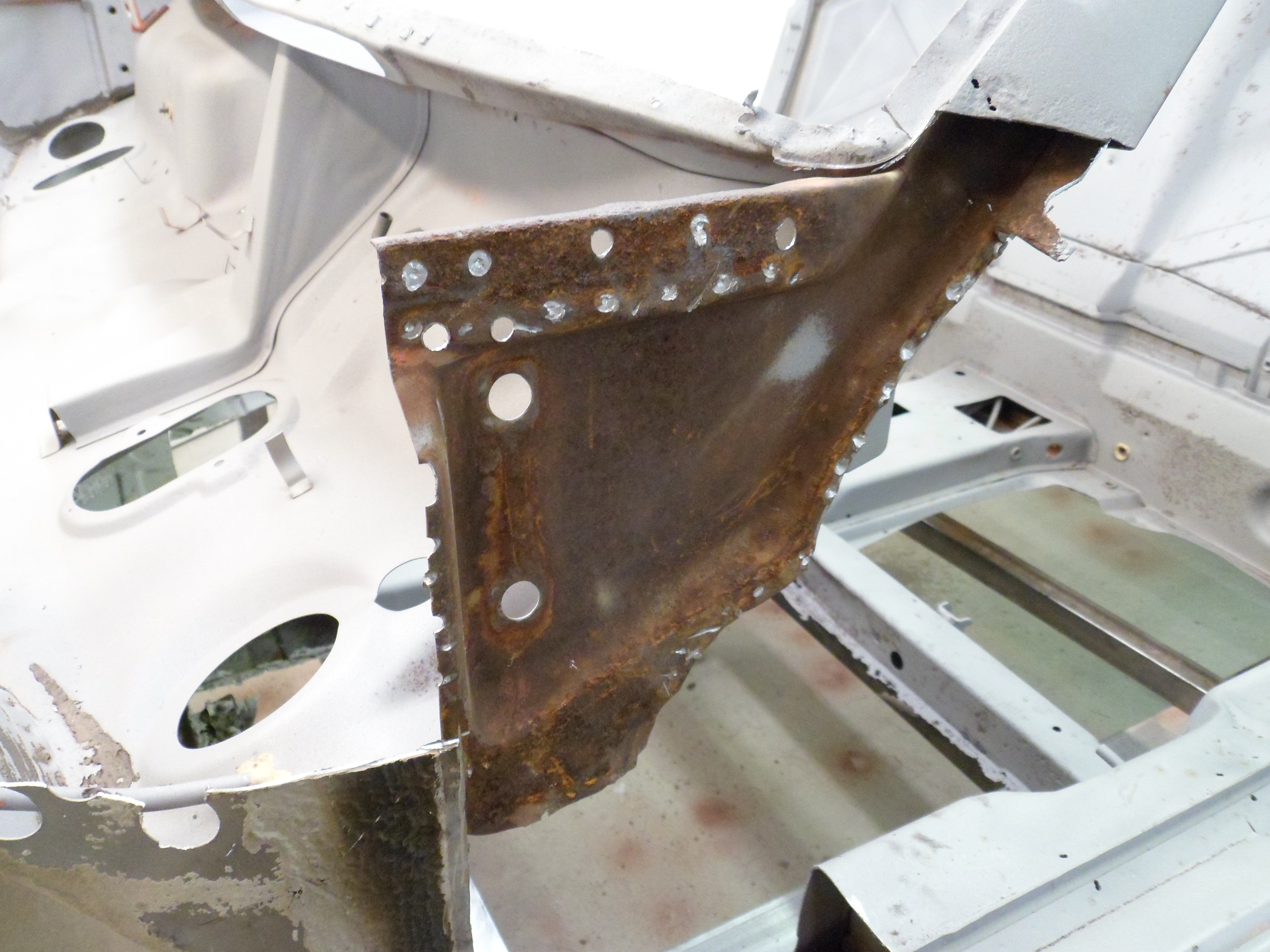

914350   More work this week.   Jan 12 2015, 11:41 AM
914350   Trimming edges.   Jan 12 2015, 11:44 AM
914350   Jim, I promise I will stop cutting before there is...   Jan 12 2015, 11:48 AM
914350   Yikes!   Jan 12 2015, 11:51 AM
