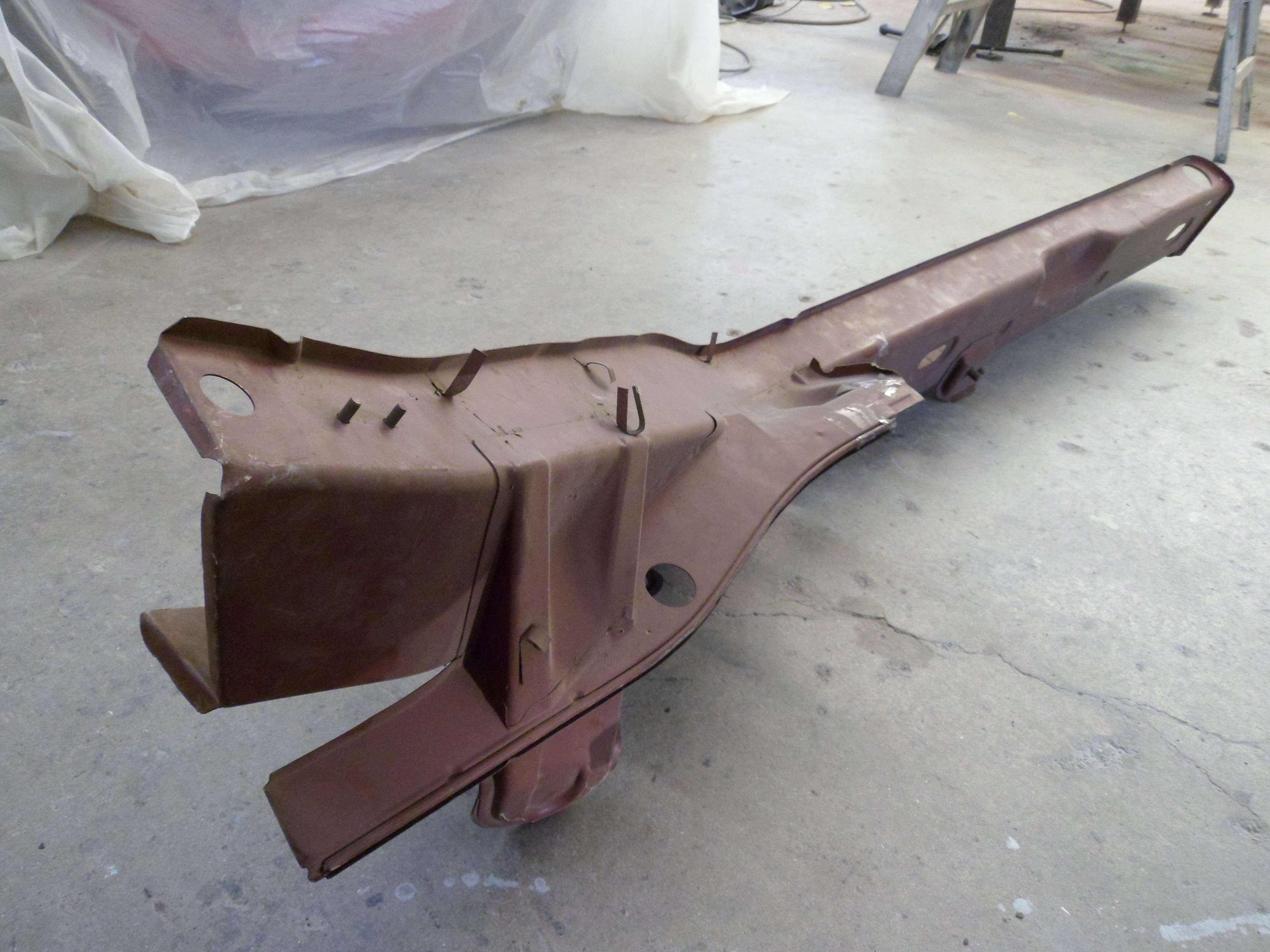

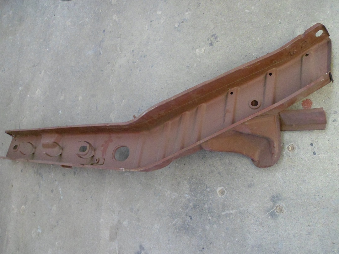

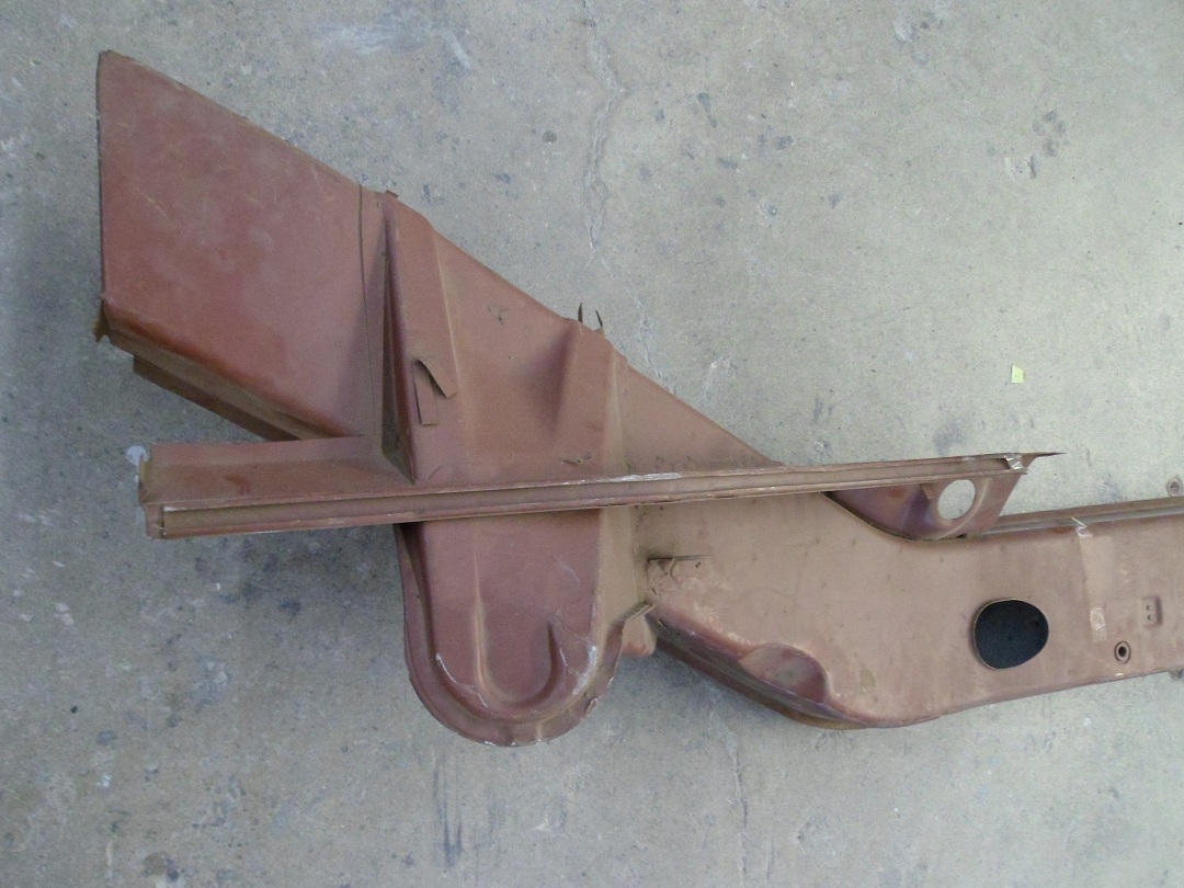

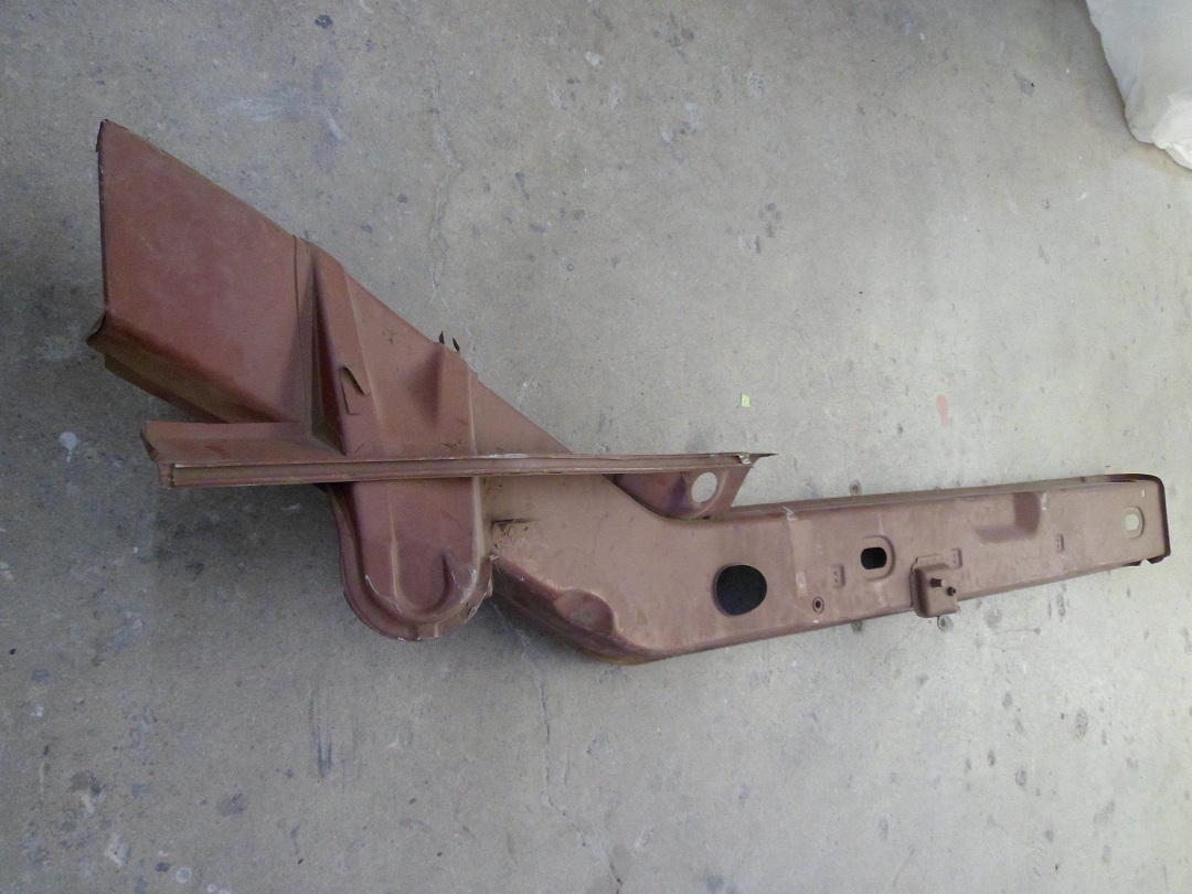

914350   Andy and Jim located a NOS drivers side long.   Jan 12 2015, 12:01 PM
SirAndy   Andy and Jim located a NOS drivers side long. :...   Jan 12 2015, 12:04 PM
