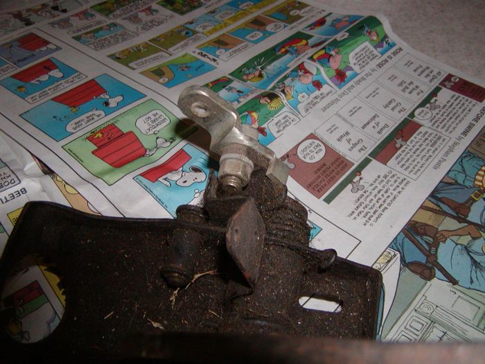

dan10101   The extender that we have isn't for the clutch...   Aug 29 2004, 11:37 AM
Brad Roberts   OK.. Back in the day. They sold a throttle arm ext...   Aug 29 2004, 11:40 AM

dan10101   Heres the clutch throw extender. And yes, my othe...   Aug 29 2004, 11:59 AM
dan10101   pic...   Aug 29 2004, 12:00 PM
Brad Roberts   Yes. That is how they are getting away with the st...   Aug 29 2004, 12:01 PM
