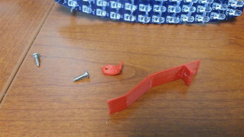

There are 2 clips for each board. The small one goes in front the the long one on the rear.

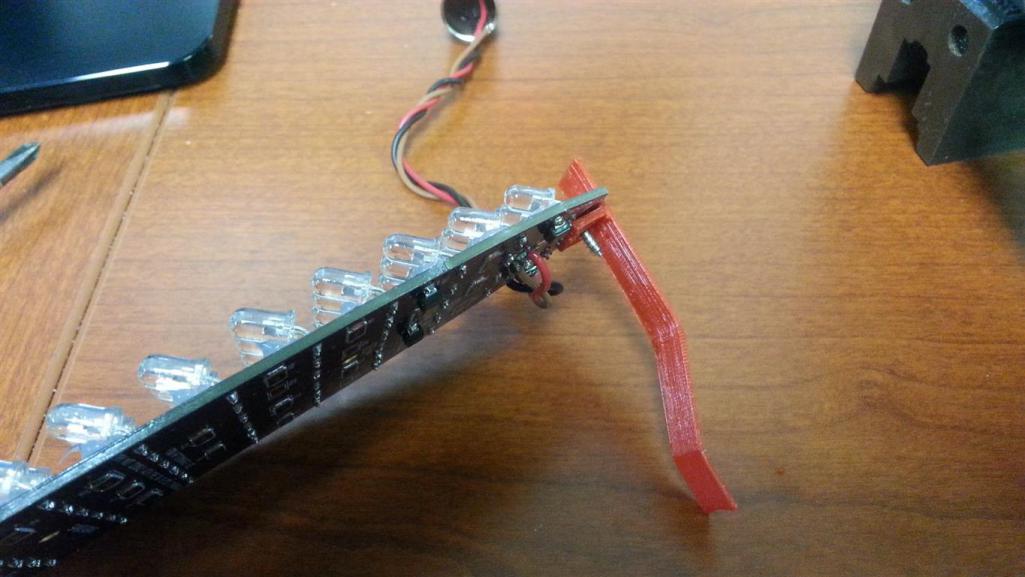

Screw in the rear clip.

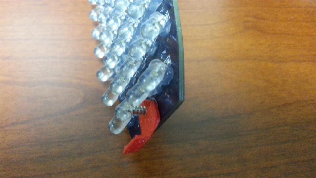

The small front clip mounts on the top of the board. These will be screwed in when I build the board. The bottom of the board will contact the bucket base to keep the board straight.

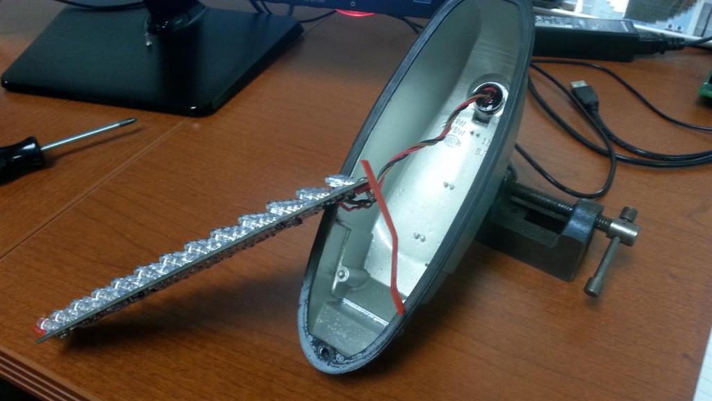

Here's the board ready for installation with the bulb base connected.
When installing the board, make sure the pigtail does not interfere with the rear clip.

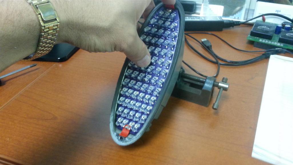

Gently slide the board in. There are slots on either side of the board to clear the guides on the sides of the bucket.

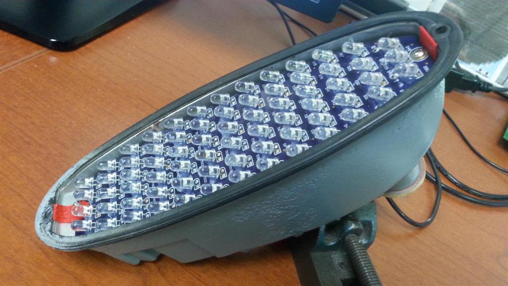

Ready for the lens. The lens will hold the board in place. If you need to reposition the board, do not grab the LEDs as they will move. Use a paper clip or similar wire to pull the board out.
