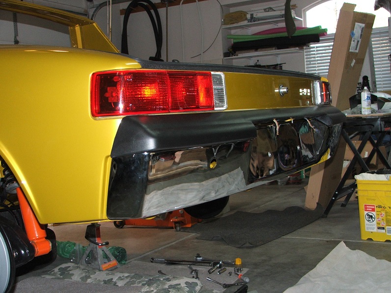

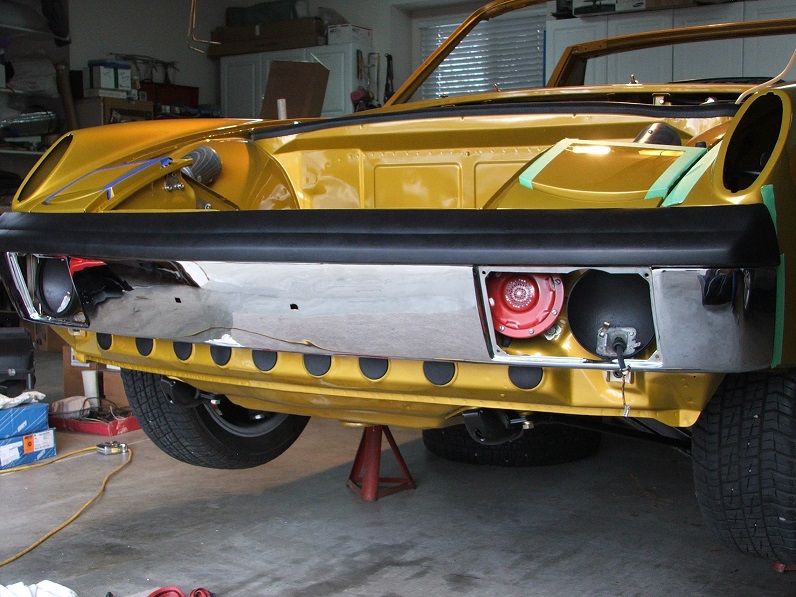

Spent the day test fitting the bumpers and messing with trying to get the headlights to line up.
The chrome shop didn't do the greatest job on the front bumper when they restored it. The drivers' side mount was just a bit off, so the holes didn't line up. (IMG:style_emoticons/default/sad.gif) I ended up putting studs on the brackets and honed out the holes in the body slightly. I'm probably going to end up getting a different one.
The back bumper fit fine.
Getting the lights adjusted is quite the adventure of trial and error. Everything still need some tweaking. I've gotten them closer than the pictures depict.
