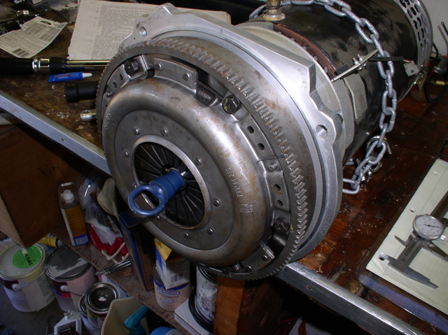

Just a few progress pics for the curious. It's not a huge amount of progress but at least it feels like the project is starting to move forward! (IMG:style_emoticons/default/smilie_pokal.gif)
This is a pic of the taper lock hub. It's the reason for my question about flywheel distance. I have about 5 cm of play here so I needed to know where the flywheel was SUPPOSED to end up. Thank you Demick for the fantastic data dump you gave me! (IMG:style_emoticons/default/pray.gif) The amazing thing about taper lock hubs is that you can remove the bolts completely and the thing still won't come off! Attached image(s)

This time for sure..
sgomes It's not much but it is FORWARD progress! Aug 29 2004, 02:24 PM
sgomes Flywheel: Demick -- the final distance was 44.2mm Aug 29 2004, 02:25 PM

sgomes Brad, yep it's stock all the way. Ok, I didn... Aug 29 2004, 02:27 PM
sgomes Oh and just cuz... here is the P. Plate: Aug 29 2004, 02:29 PM
