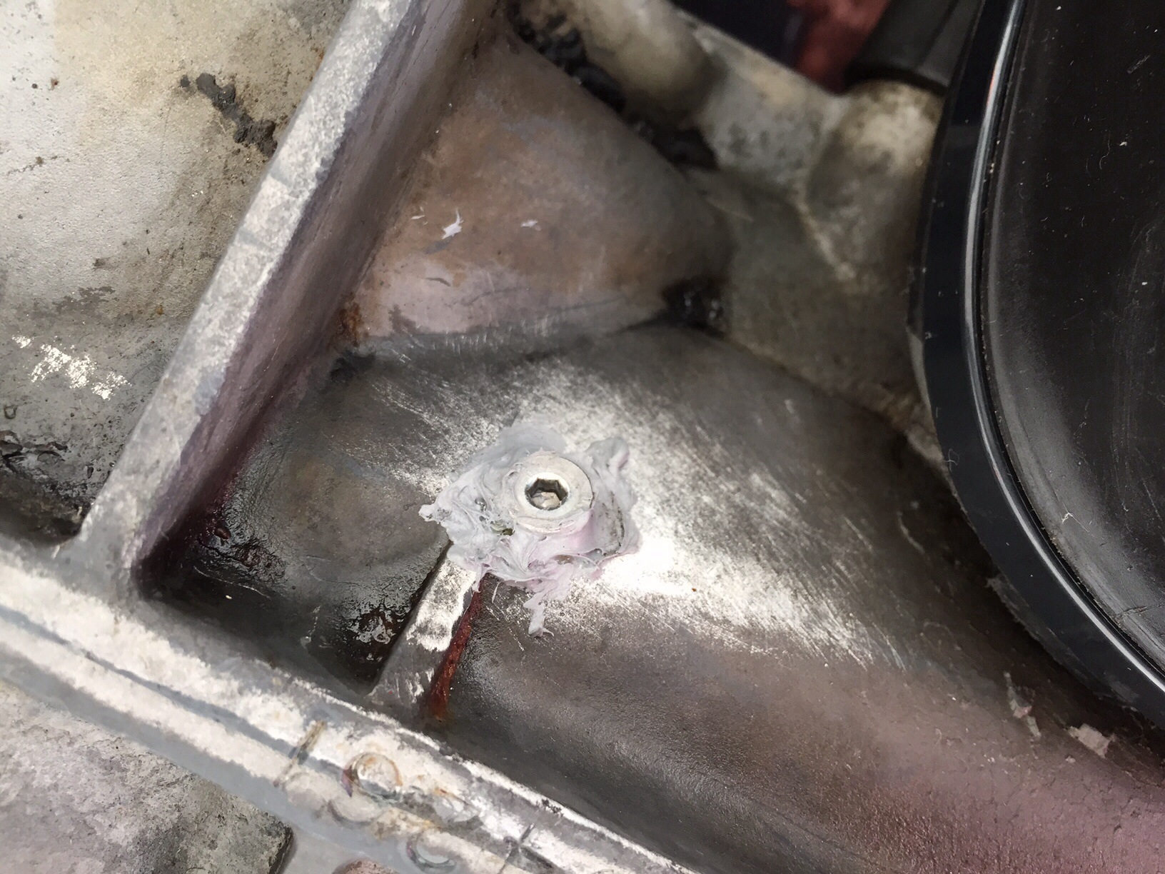

I have a tranny case leak that needs a repair. Here is a pic of the leak, which when warmed up is about one large drop a second.
I figure that I should do a real weld for the permanent fix, but would like to do a temp fix so I can drive over to my welder brother-in law about a 100 miles away.
So, what is the best liquid weld goop for this type of a hole (about 1-2 mm in diameter)?

Pic after my repair job. I screwed in a metal screw, and coated it with Permatex Gear Oil RTV Gasket Maker.Attached Image
I used a hex head metal screw with a flathead top that allowed room to goop it.

Harpo   Your trans case is magnesium. Good luck David   Jan 11 2015, 12:15 PM
Mike Bellis   Drill it, tap it and install a plug. Or Find a n...   Jan 11 2015, 12:18 PM
Hank914   Drill it, tap it and install a plug. Thanks for...   Jan 11 2015, 12:35 PM
Mike Bellis   Drill it, tap it and install a plug. Thanks fo...   Jan 11 2015, 12:47 PM
jd74914   If the case is magnesium, you will not be able to...   Jan 11 2015, 04:10 PM
SirAndy   Drill it, tap it and install a plug. :agree: I...   Jan 11 2015, 02:03 PM
Bruce Hinds   It would be a no brainer to try the JB weld. I...   Jan 11 2015, 03:50 PM
veekry9   Welding is possible,but,the damaged area will requ...   Jan 11 2015, 05:10 PM
partwerks   I used JB weld on a old 30+ year old, Campbell Ha...   Jan 11 2015, 07:42 PM
veekry9   Oh yeah,I used the stuff for similar repairs,indis...   Jan 11 2015, 07:59 PM
a few loose screws   I'm another vote for installing a plug. As a s...   Jan 12 2015, 06:32 AM
Geezer914   If the hole is small, say 1/8" just run a sm...   Jan 12 2015, 07:09 AM
johnhora   I've used JB Weld on 911 mag intake manifolds ...   Jan 12 2015, 10:53 AM
veekry9   http://solutions.3m.com/wps/portal/3M/en_U...81606...   Jan 12 2015, 11:17 AM
iamchappy   JB Weld will work fiine, it's whats used on th...   Jan 12 2015, 11:25 AM
Dr Evil   A little back story... This is the replacement tr...   Jan 12 2015, 11:41 AM
Hank914   A little back story... This is the replacement t...   Jan 20 2015, 01:37 AM
Cap'n Krusty   Every one of these solutions, except maybe drillin...   Jan 12 2015, 11:45 AM
Dr Evil   I can verify, but a 1/8" or slightly bigger p...   Jan 12 2015, 11:56 AM
a few loose screws   You can patch a leaking case without getting it pe...   Jan 12 2015, 12:17 PM
CatDaddy60   I have a Case that ran afoul of a wayward axle sha...   Jan 13 2015, 06:27 PM
Dr Evil   For a small spot like Hank's, no prob to just ...   Jan 13 2015, 07:49 PM
relentless   One more tip if you do drill and tap it. Coat the...   Jan 14 2015, 04:24 PM
Hank914   Thanks everybody for the comments and advice. I w...   Jan 18 2015, 08:18 PM
Dr Evil   Looks great ;)   Jan 18 2015, 08:21 PM
Hank914   Pic after my repair job. I screwed in a metal scr...   Jan 18 2015, 08:22 PM
Dr Evil   Did it work? If it gives you issues, change to NPT...   Jan 18 2015, 08:28 PM
Hank914   And then I had to go have a few :beer3: while i...   Jan 18 2015, 08:29 PM
Hank914   So yes, there is some yellow, which is oil. But m...   Jan 18 2015, 08:30 PM
Dr Evil   Ya, that is why they use pipe tread on the plugs, ...   Jan 18 2015, 09:53 PM
