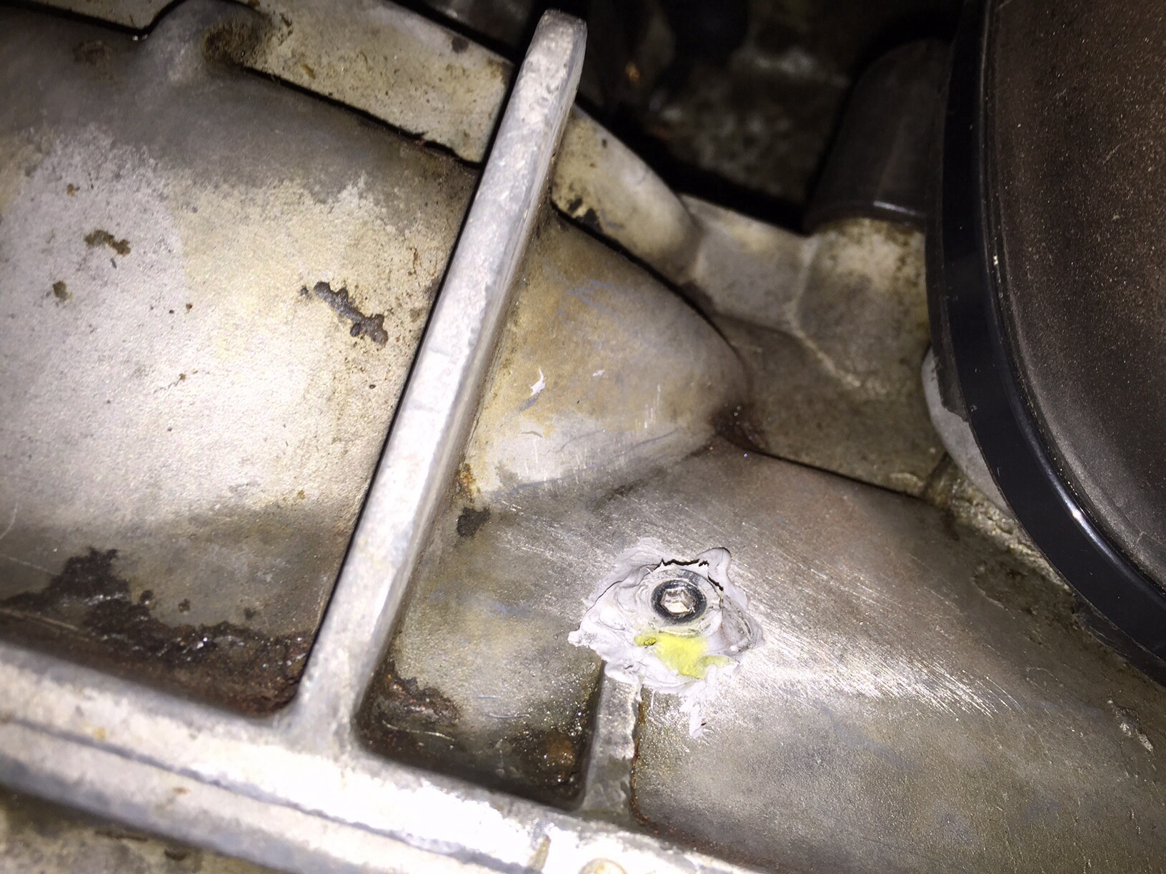

And then I had to go have a few (IMG:style_emoticons/default/beer3.gif) while it cured for 24 hours.
Then I had to (IMG:style_emoticons/default/driving.gif) it for about 10 miles in the garage on jack stands (with a book on the gas pedal and it in 5th gear) since I did not want to coat the neighborhood streets with oil if my fix did not work. Since that seemed to work well, I it took for a test drive. After about 75-100 miles and 3 plus hours, this is what the fix looks like now.

Hank914   Pic after my repair job. I screwed in a metal scr...   Jan 18 2015, 08:22 PM
Dr Evil   Did it work? If it gives you issues, change to NPT...   Jan 18 2015, 08:28 PM
Hank914   And then I had to go have a few :beer3: while i...   Jan 18 2015, 08:29 PM
Hank914   So yes, there is some yellow, which is oil. But m...   Jan 18 2015, 08:30 PM
Dr Evil   Ya, that is why they use pipe tread on the plugs, ...   Jan 18 2015, 09:53 PM
