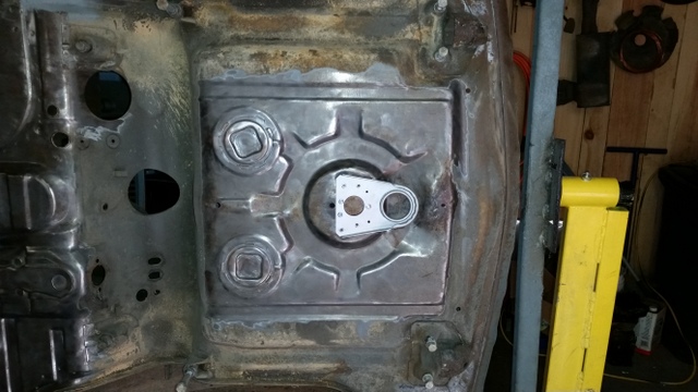

After finishing my rotisserie I am finally getting back to actual car work (started in 03). I am redoing what I did in the past (made a mess of it) and hopefully moving on from there. Doug has is helping me with the restoration, so hopefully we can make some actual progress. The entire passenger side of my car is pretty rotten so we have our work cut out for us. I got the good part of the long cut out so when Doug gets here maybe we can start filling in the gaps.
In this pic I have cut out the outside long bit.

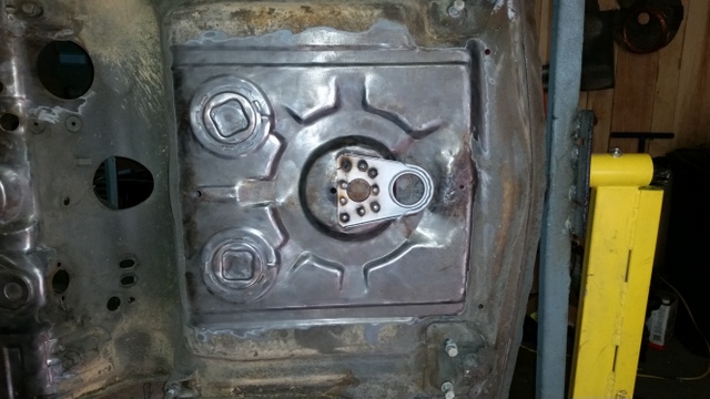

It was nice and warm today so I got a little more done on the car. The bottom is really starting to shape up. I still need to add the reinforcement parts and the floor will be done. Then it is onto the inside of the cabin, rear quarter and rear trunk floor.

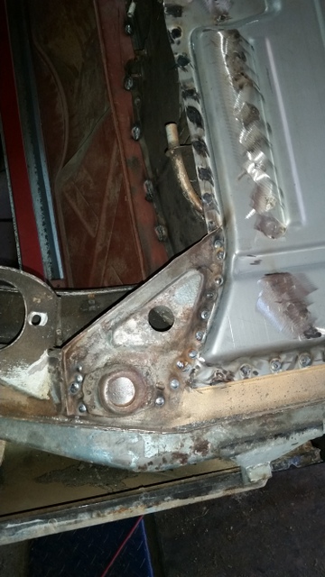

trojanhorsepower   I may have accidentally gotten the engine mount in...   Oct 3 2014, 04:45 PM
dlee6204   Good timing on the update... Was just about to te...   Oct 3 2014, 04:52 PM
trojanhorsepower   Great! Any recommendations on placement? Als...   Oct 3 2014, 04:55 PM
dlee6204   Metal on metal. Only early cars had rubber outbo...   Oct 3 2014, 05:11 PM

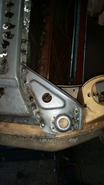

FourBlades   I replaced one of mine that was really rusted out....   Oct 13 2014, 07:22 PM
trojanhorsepower   Thanks John, Other experts please chime in..... ...   Oct 15 2014, 02:10 PM
FourBlades   Here is a picture after I replaced mine. There is...   Oct 15 2014, 07:25 PM
trojanhorsepower   Thanks John, I will check those tomorrow.   Oct 15 2014, 07:44 PM
