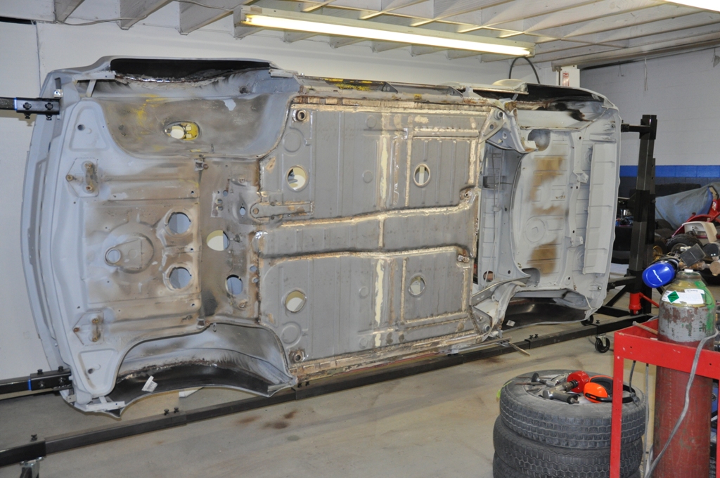

saigon71   Post #25 and #185 shows how I fabricated pieces of...   Jan 20 2015, 02:39 PM

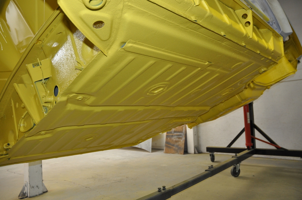

Socalandy   No regrets ordering the RD pans here. Very nice pa...   Jan 20 2015, 08:17 PM
