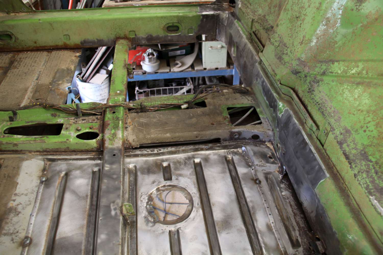

Seems everyone is focused on the time and money not the experience.
Dad and I made our own floorpan replacement section and it didn't turn out too bad.
I did end up buying a full pan and extra panels from resto design but I'm glad we did our own first as it's helped with other panels I've had to make from scratch.
