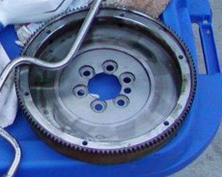

One of our benifactors sold us a flywheel that he used with a kevlar disk. With only a few hundered miles on it, the flywheel is heat spotted. Light usage, normal HP V8.

dan10101   One of our benifactors sold us a flywheel that he ...   Aug 29 2004, 11:08 PM
dan10101   I forgot to add why the post. He was concerned ab...   Aug 29 2004, 11:14 PM
Brad Roberts   Turn it just like you would any other flywheel. It...   Aug 29 2004, 11:35 PM
