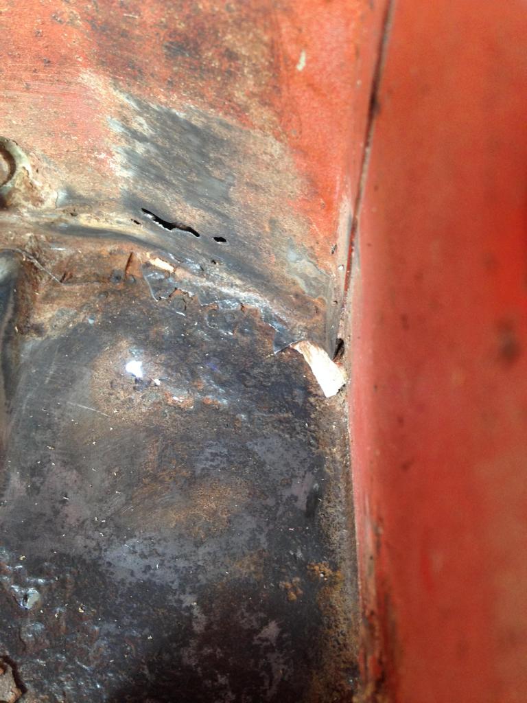

I am moving back over here with rust repair of my project.
As you can see I'm back at it. Photos are the only 2 areas on the floor that will nee work. I'm thinking a small welded in panel ? Ideas from what you guys have done ?
(IMG:http://www.914world.com/bbs2/uploads_offsite/i257.photobucket.com-8123-1422303083.1.jpg)
(IMG:http://www.914world.com/bbs2/uploads_offsite/i257.photobucket.com-8123-1422303083.2.jpg)
