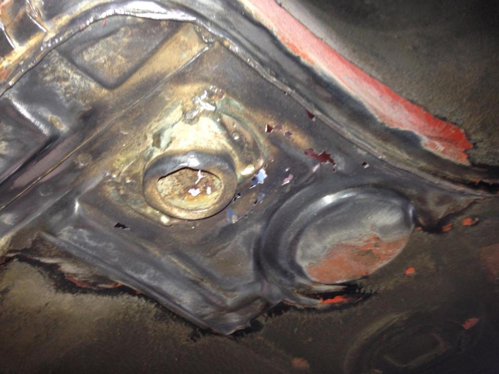

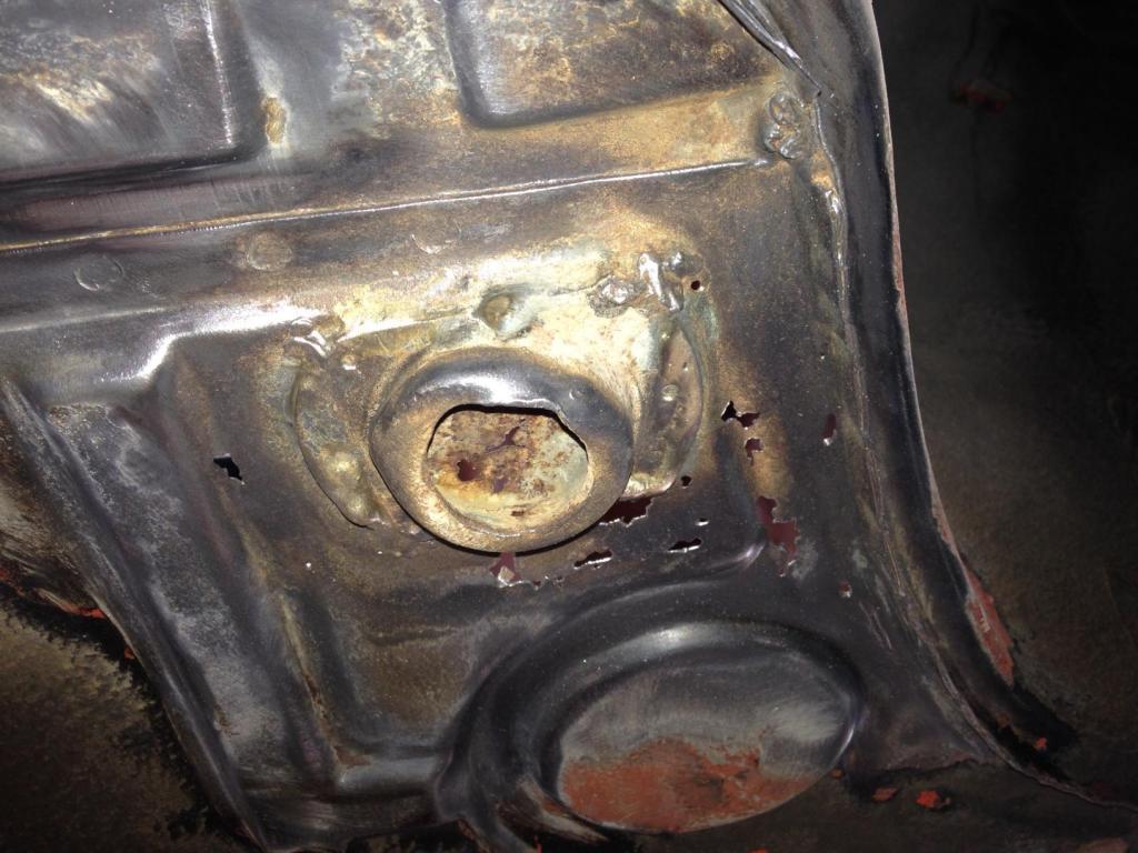

From the bottom.
(IMG:http://www.914world.com/bbs2/uploads_offsite/i257.photobucket.com-8123-1422306743.1.jpg)
(IMG:http://www.914world.com/bbs2/uploads_offsite/i257.photobucket.com-8123-1422306743.2.jpg)
