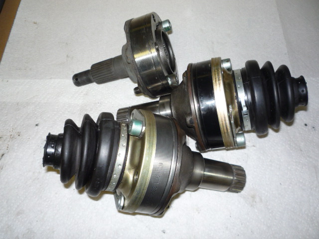

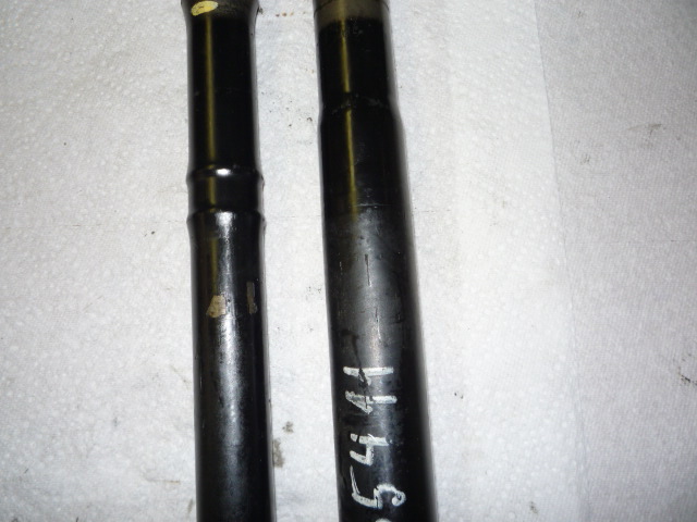

Ok, here is the last of what I have found out using the Boxster and later 993 axles. The 911 and Boxster axle are the same length, are hollow tubed and use a 28 spline. The 911 axle is 32 mm thick and the Boxster is 28mm thick. Both are to long for 914 use. The Boxster S inner CV is a 911.332.030.01 , 108mm and 32mm thick. It is used in bunch of Porsche applications including the 930 Turbo. The 911 inner CV only had a Lobro part 7253150199001 and it is only 28mm thick. Both CV's used a 928.332.293.02 boot.
I had some 110mm 911 stub axles so I bolted the CV's up. I see no reason why the CV would not work for this application with joint gasket.
The outer stubs are a completely different item. The flanges are crimped on and no replacements are available. CV joint cup could be machined off and holes drilled. Not cost effective to use them. The overall height is the same but each is machined differently.
In summation the only useable part would be the Boxster hub. The 914-6 rotor would have to be drilled and screw holes countersunk to allow the hub to be screwed to the hub. The 911/944 stub axle will required a 8mm spacer at the top of the stub axle so it can be tightened down.
So, I spent some money and learned some new information. It seemed like a good plan at the time but NOT worth the cost of modification required to make it all work.
