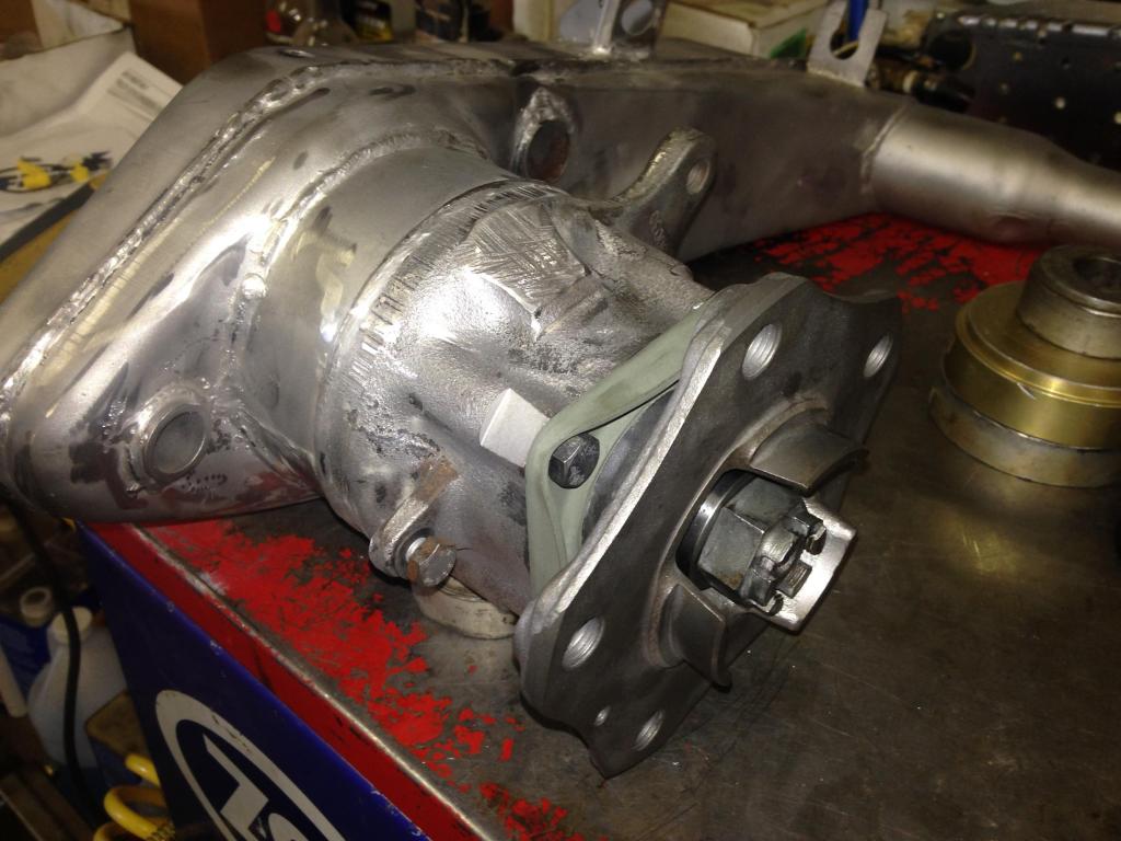

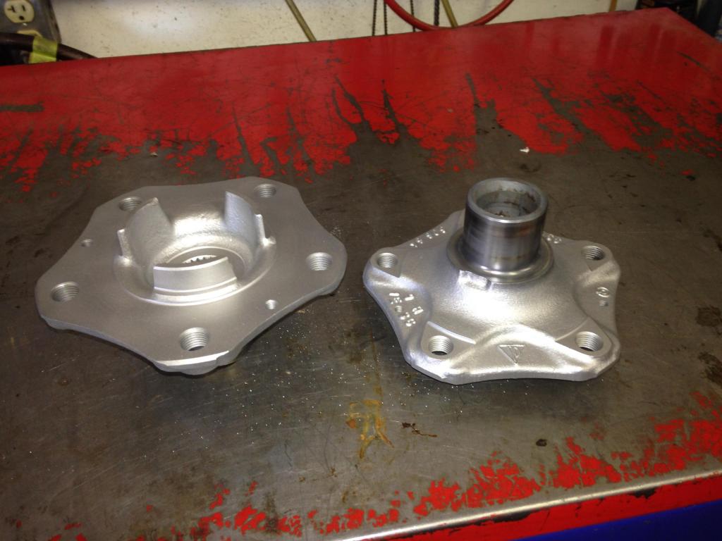

We all know that 69-73 911 rear hubs are getting scarce and pricey. I went out on a limb and bought a whole rear 99 Boxster assembly for $41 delivered on EBAY. It is a well known fact that the 914 and the Boxster use the same wheel bearing. So I figured it would be an easy swap. I drove the hub out of the bearing and started the comparison of the two hubs. I had a 69-73 911 rear hub and a -6 stub axle to use as a baseline. The Boxster hub has the same splines as the 911/914-6 stub axle so it was a drop in fit. One down, so I put them side by side to find out they are the same height. Now have two down, the last check was to set the rotors on both hubs to see where we were at. Bingo, they matched up. So the stub, the hub and the height are all the same. HOWEVER, there is one area to be addressed. the -6 stub sticks up about 5mm past the center of the hub. It is going to require a spacer to fill in the area so the washer and nut will tighten down. I am thinking that the one that Patrick Motor sports will do the trick. I think it will be worth trying because I am using Boxster wheels.
Tell me what you think.

IIRC, the Boxster stub axle is a 6 bolt that is the same size as a 944 turbo CV joint. Use the Boxster hub and stub, and then use the 944 CV conversion procedure.
Should be a complete bolt on for a 914.

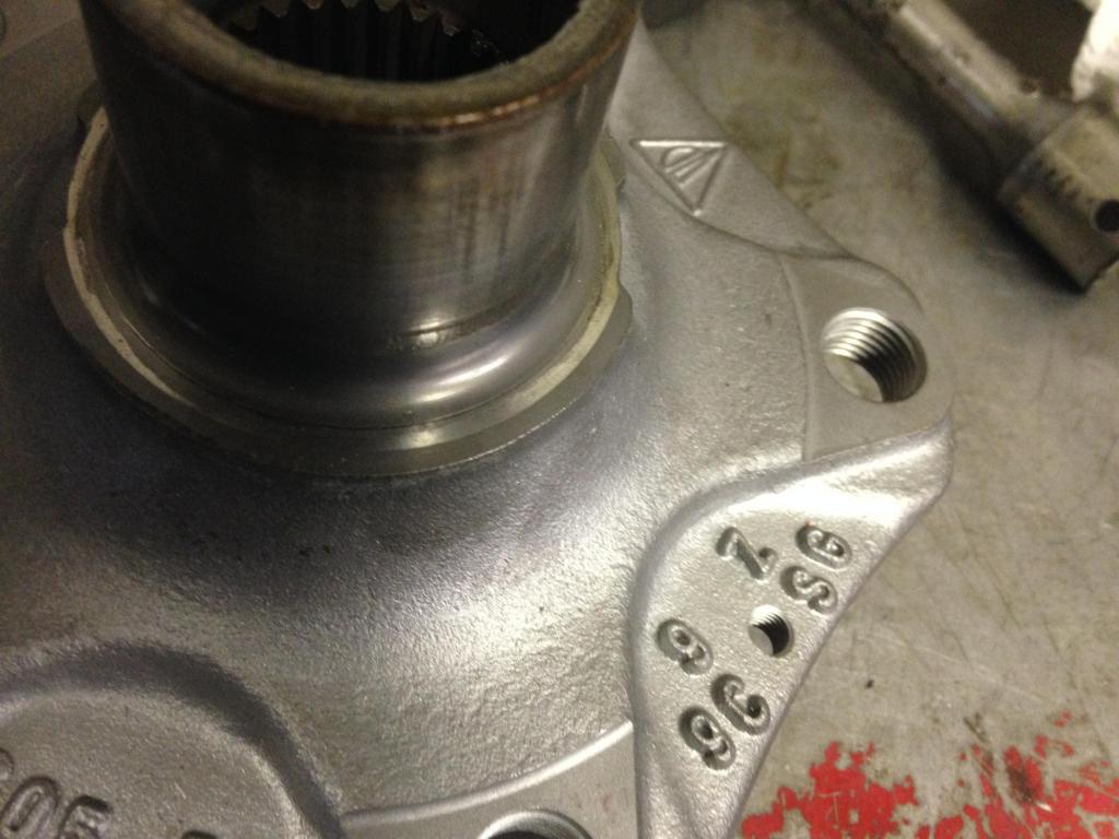

I used a 97-04 boxster rear hub. Part number 996.341.605.54 on the hub. I just ordered a Boxster axle to check out what Clay said about getting the stub off and using a 944 CV Joint.

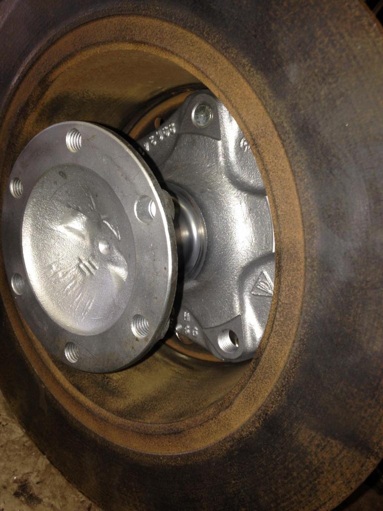

...HOWEVER, there is one area to be addressed. the -6 stub sticks up about 5mm past the center of the hub.
Does the 911 stub also have the 5mm stickup or just the -6?

914Sixer
Dec 16 2014, 04:57 PM
Yes, the 911 stub axle sticks up the same amount as the -6 stub.

Whole rear Boxster hub assemblies can be had for less that $50 shipped on Ebay. You will have about 5 lbs of scrap aluminum when you are done.

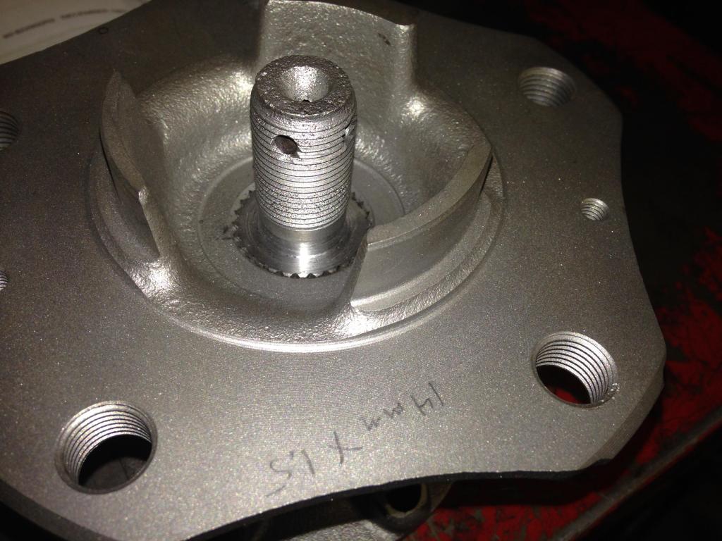

I ordered in some Box outer hubs.
If I read this post right. I need a 911 axle/stub, drill and tap for a rotor mount and a spacer .?
With my build being a Subaru motor and trans , what outer CV will be needed ? Being new to this it looks like a 911? Is it the same as the 944 CV ?
My plan is to use the axles from ColdWater914. Subaru on the trans and it looks like 914 or 944 on the axle.
With this in mind ,if I go with a 911 rear vented rotor with 911 parking brake and kit. What will this change ? What will I also need ?

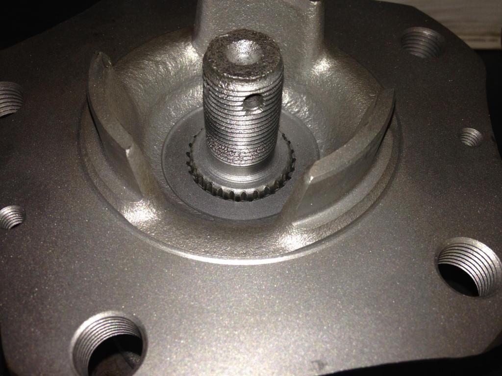

Feb 10 2015, 12:43 PM
Mueller
Feb 10 2015, 01:02 PM
^Looks good, instead of cutting the stub axle I would have just added a chamfer or radius or counterbore to the spacer.
914GTSTI
Feb 10 2015, 02:11 PM
Yep, I looked at that but wanted just a little more contact . Like .007, LOL .

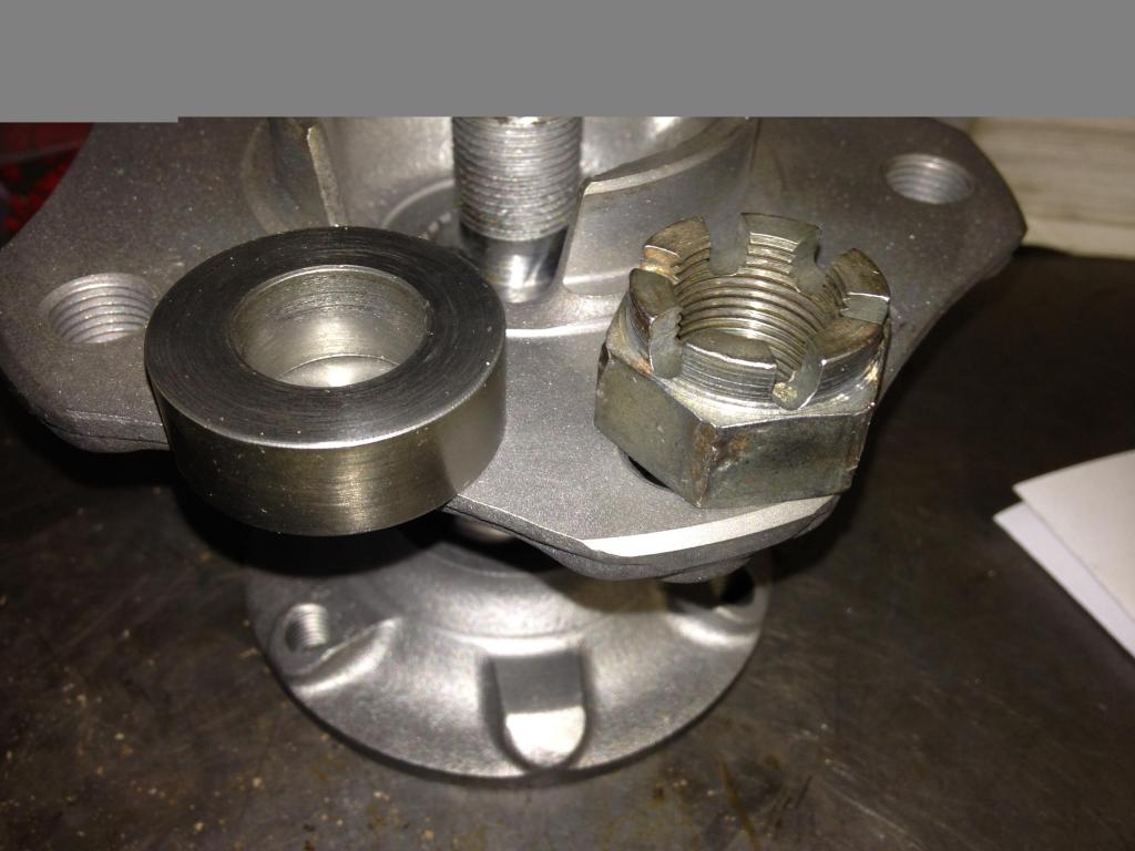

Harpo
Feb 10 2015, 04:28 PM
Make sure your spacer is as hard as your nut (HRC) or you will have gaulling on your bearing surface and end up with a lot les clamp load in your joint.

Thanks David,I will keep a eye on that.

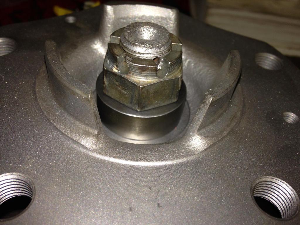

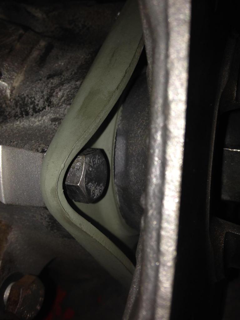

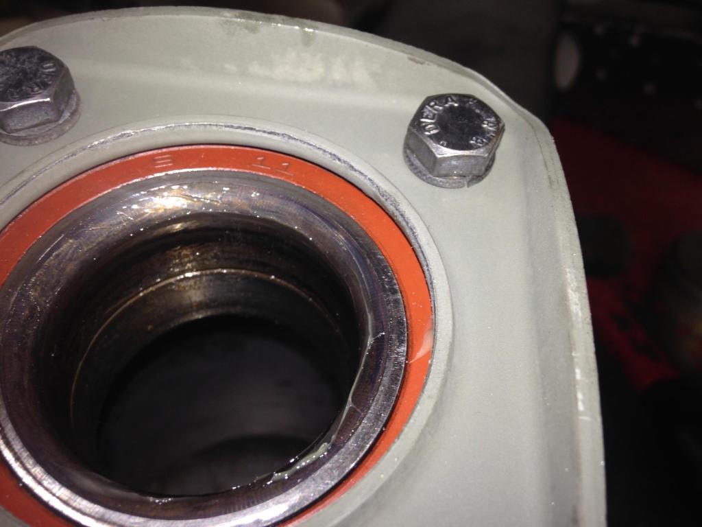

So it will not be plug and play. The the hub will need to be cut to clear the bearing flange. If you look at the green paint ,its missing.
Going to be tight in their with the 108's !

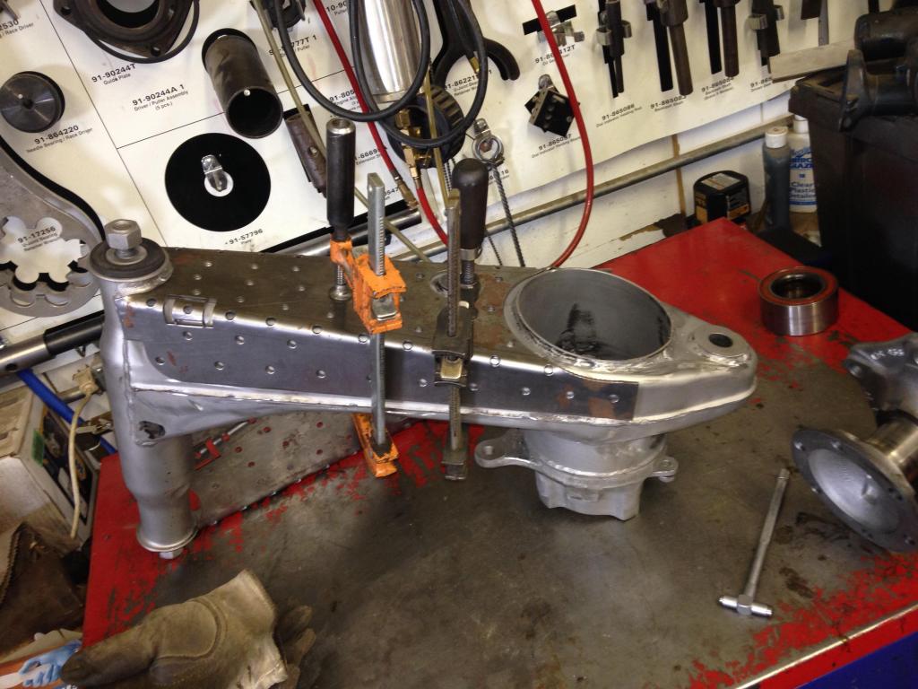

And I stopped at Patrick Racing and got the trailing arm stiffeners. Welding in the AM.
One last thing,I don't think it will need any cutting on the stub shaft. More in the AM. But I have a set !

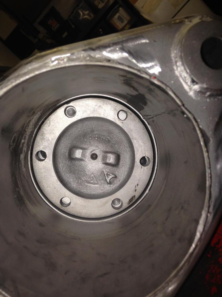

Any chance the Boxster bearing flange will bolt to the 914 trailing arm.
Cheers,
Scott
914GTSTI
Feb 10 2015, 09:01 PM
Good idea. I will look at it tomorrow. But I don't think so. It is a non-symmetrical pattern on the Boxster.
If I built a holder I could cut down the bearing flange shoulder ? Maybe in the field it could just be ground down ?
I will cut one of the stubs and see what clearance will be needed. Need to take a look at the 130x4 hub.
