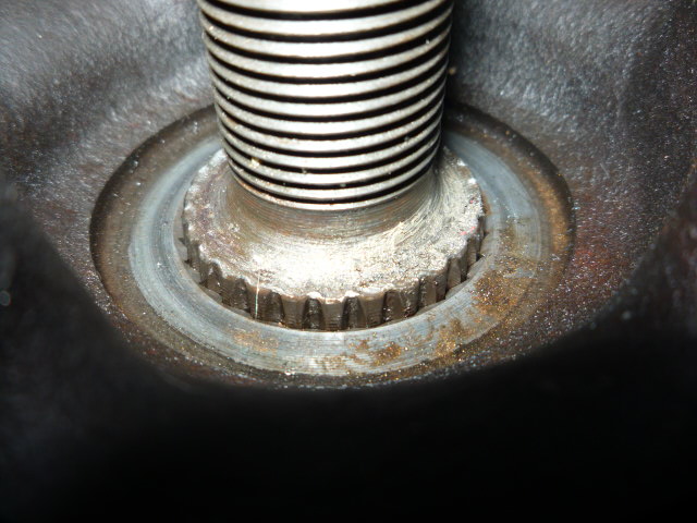

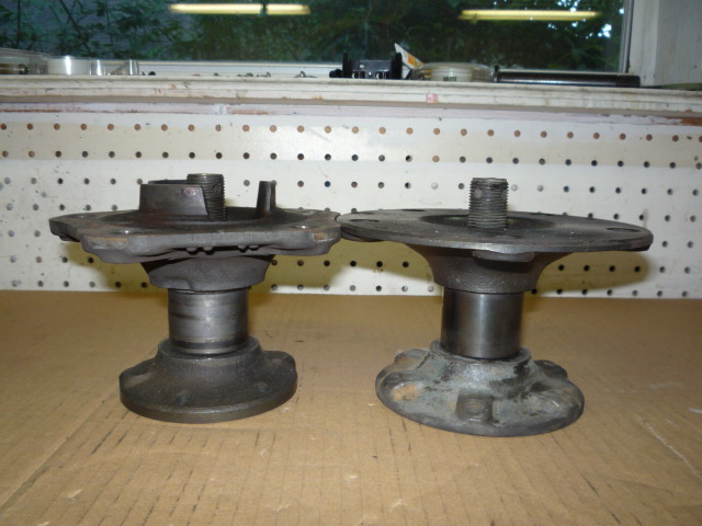

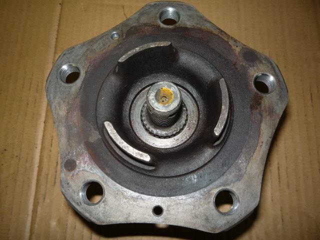

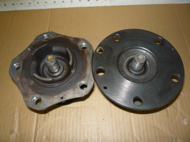

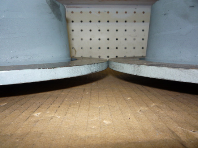

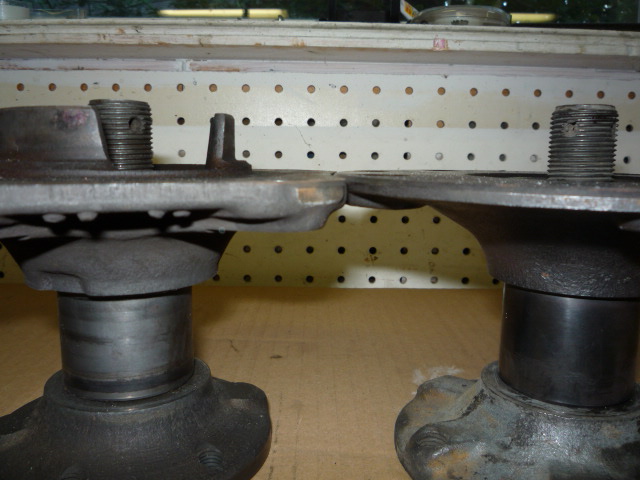

We all know that 69-73 911 rear hubs are getting scarce and pricey. I went out on a limb and bought a whole rear 99 Boxster assembly for $41 delivered on EBAY. It is a well known fact that the 914 and the Boxster use the same wheel bearing. So I figured it would be an easy swap. I drove the hub out of the bearing and started the comparison of the two hubs. I had a 69-73 911 rear hub and a -6 stub axle to use as a baseline. The Boxster hub has the same splines as the 911/914-6 stub axle so it was a drop in fit. One down, so I put them side by side to find out they are the same height. Now have two down, the last check was to set the rotors on both hubs to see where we were at. Bingo, they matched up. So the stub, the hub and the height are all the same. HOWEVER, there is one area to be addressed. the -6 stub sticks up about 5mm past the center of the hub. It is going to require a spacer to fill in the area so the washer and nut will tighten down. I am thinking that the one that Patrick Motor sports will do the trick. I think it will be worth trying because I am using Boxster wheels.
Tell me what you think.

I will be working on a update for this weekend. Boxster axles came in but they do not look promising. -6 rotor will require new holes to hold rotor on boxster hub.
