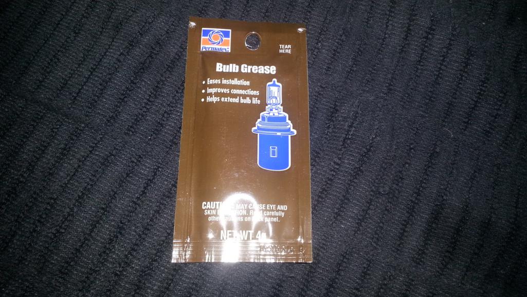

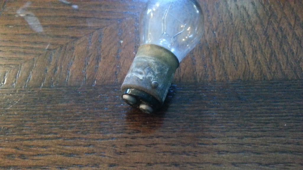

A couple of folks have had issues installing the bulb bases into the existing sockets. Much of the difficulty has to do with the existing socket which is over 40 years old and may likely have suffered from aging and moisture. This makes the bulbs hard to install/remove and can affect the electrical connection to the bulb.
This is a good time to do some preventive maintenance on the socket to improve electrical connectivity and ease installation of the LED bulb bases or even the standard bulbs.
Here's an example of a bulb with severe oxidation and crud that came off of my 930. This bulb was so hard to remove that I thought the bulb was going to break in my hand as I removed it. Likewise the socket looked in the same condition. I connected an LED board for the 911 in its place and it didn't light up at all. I had to clean the socket with a wire wheel on my Dremel before the LEDs would light up.
After cleaning the socket with a wire wheel, or scraping the crud with a small screwdriver, dielectric grease like this one are available at your FLAPS for less than $2 goes a long way to improving electrical contact and easing installation of bulbs/LEDs.
