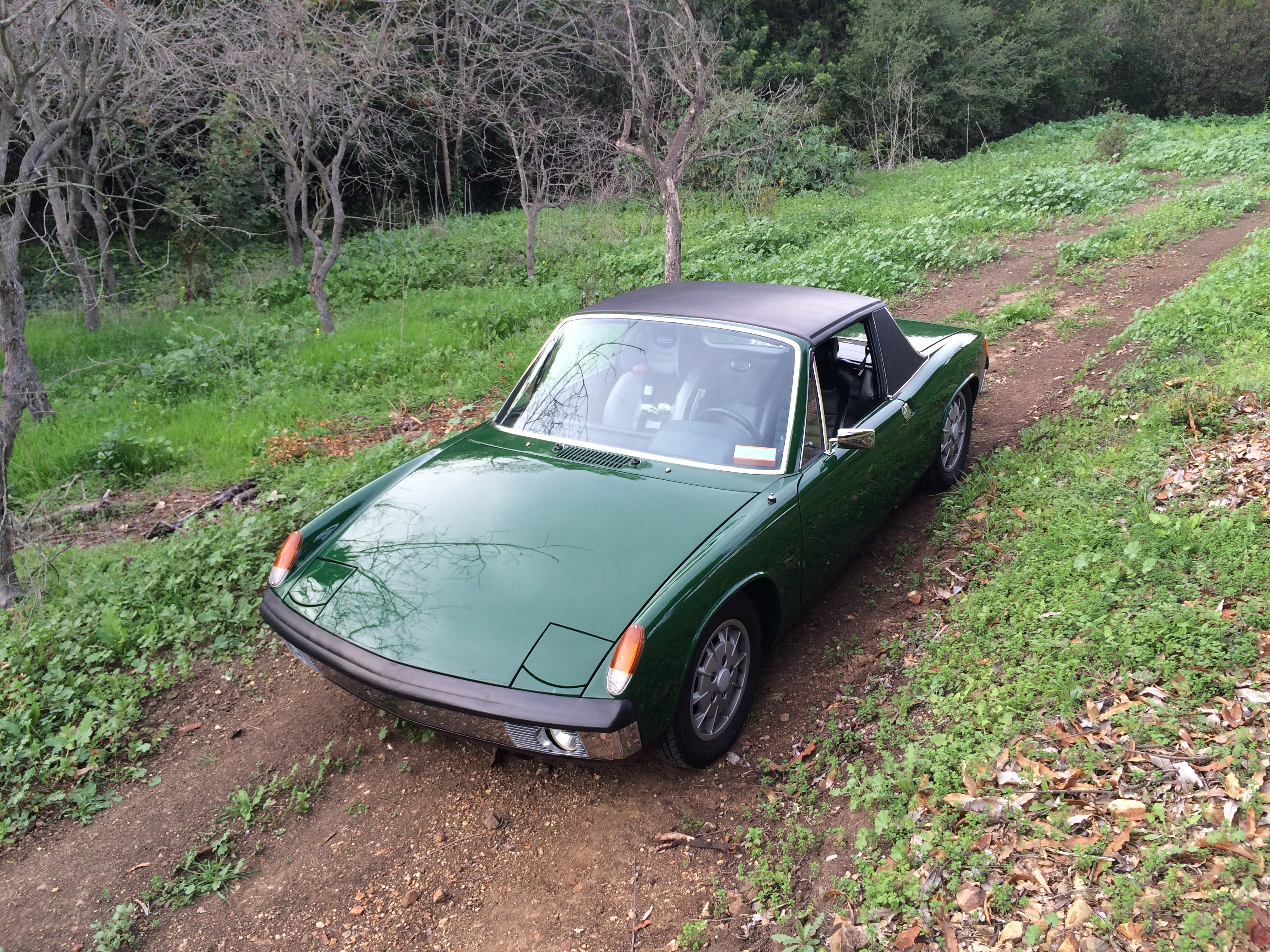

I beat you to it! (IMG:style_emoticons/default/smile.gif)

Love the Irish Green and Mahle's
