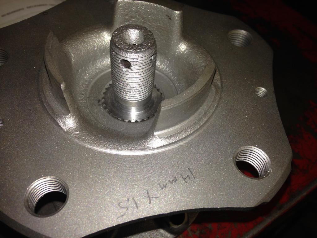

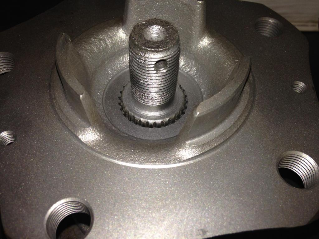

A little more work on the Boxster to 108 axle. I'm not going to use a spacer. So I cut the spline about .112". (now I'm going to here it?)
After I get the trailing arms cleaned up I will put it together.
(IMG:http://www.914world.com/bbs2/uploads_offsite/i916.photobucket.com-8123-1423512413.1.jpg)
(IMG:http://www.914world.com/bbs2/uploads_offsite/i916.photobucket.com-8123-1423512413.2.jpg)
The spline on the Boxster hub will need to be cleaned up a little.

914GTSTI   A little more work on the Boxster to 108 axle. I...   Feb 9 2015, 02:06 PM
914GTSTI   Well you will need a spacer. I forgot the castle n...   Feb 9 2015, 05:35 PM
