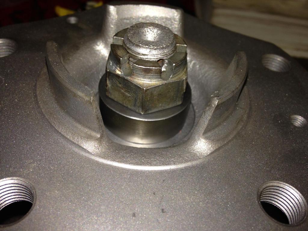

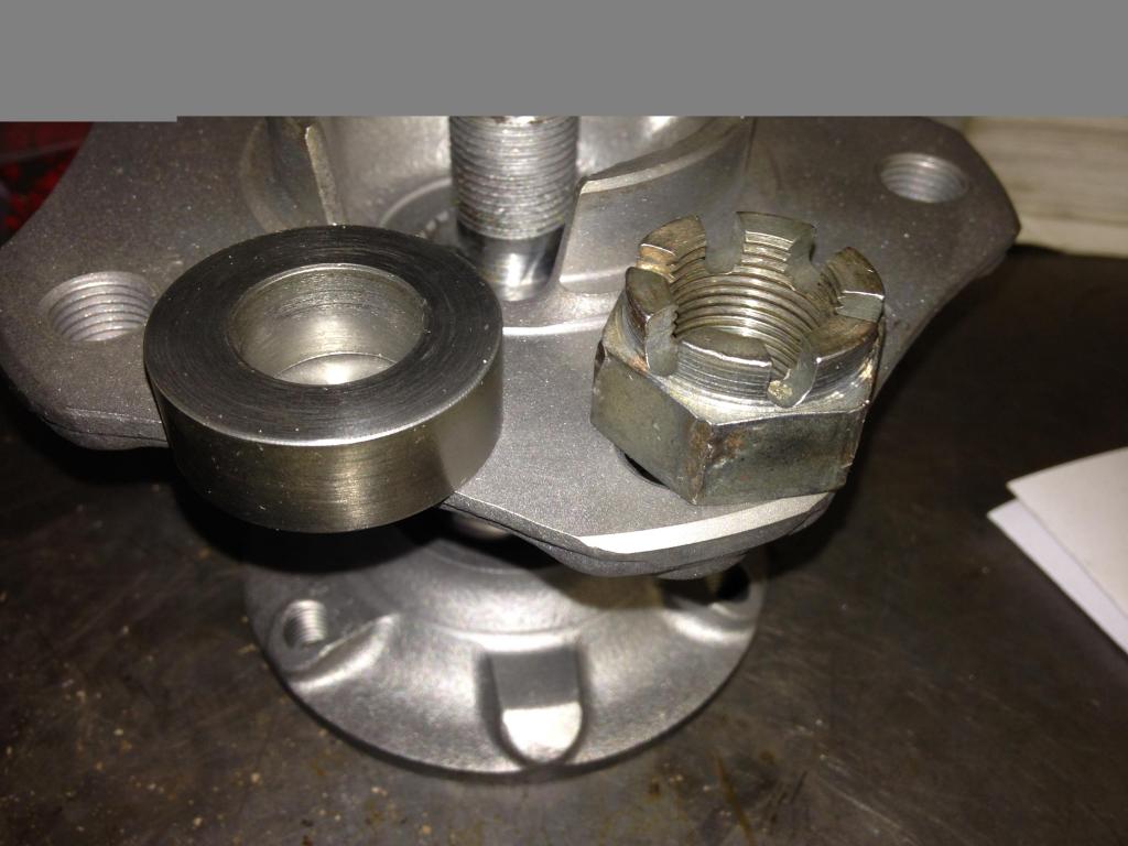

Well you will need a spacer. I forgot the castle nut ! My bad. (IMG:style_emoticons/default/chair.gif)
So I made one. I will still shorten the spline . Want the spacer to sit very close to the shaft. The space could be stepped but I feel it will hold its shape better flat. Should torque up better ?
(IMG:http://www.914world.com/bbs2/uploads_offsite/i916.photobucket.com-8123-1423524917.1.jpg)
(IMG:http://www.914world.com/bbs2/uploads_offsite/i916.photobucket.com-8123-1423524917.2.jpg)
You could say its a thick washer ? (IMG:style_emoticons/default/lol-2.gif)
