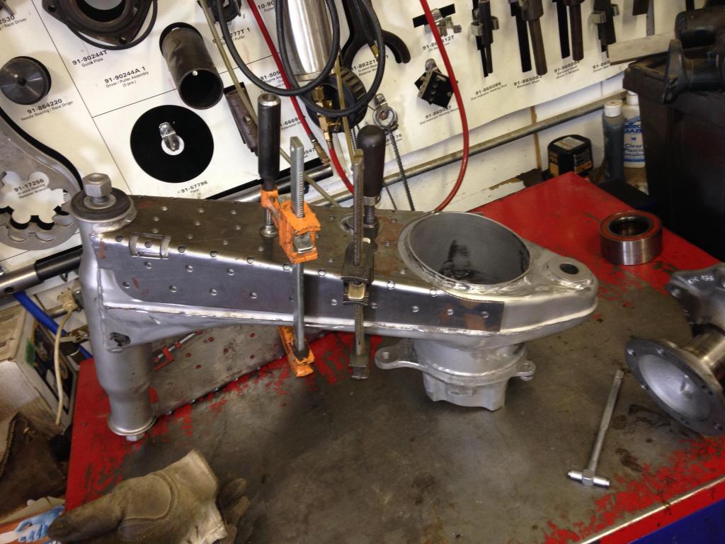

A stiffey ?
(IMG:http://www.914world.com/bbs2/uploads_offsite/i257.photobucket.com-8123-1423624618.1.jpg)

914GTSTI   A stiffey ? http://www.914world.com/bbs2/uploads_...   Feb 10 2015, 09:16 PM

914GTSTI   Yes I will use my mill. I now have one stiffie ...   Feb 11 2015, 06:32 PM
