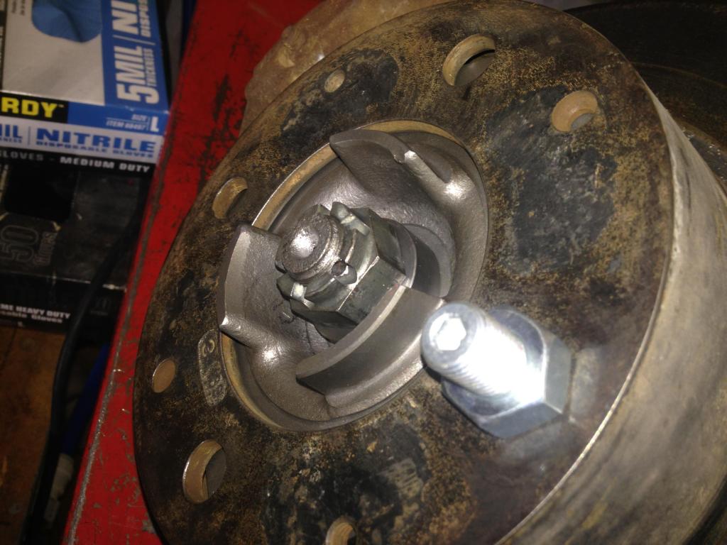

914GTSTI   I got a set of Boxster hubs. Now I need to know if...   Feb 4 2015, 12:58 PM
914GTSTI   I, cleaned up a 914-4 brake rotor and bolted (one ...   Feb 5 2015, 05:27 PM

914GTSTI   I also found a stud set for the hubs. What kind on...   Feb 5 2015, 05:34 PM

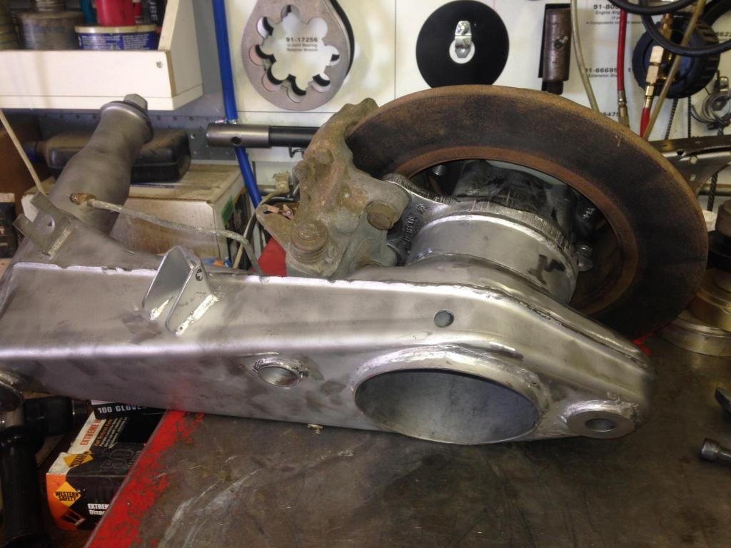

914GTSTI   So I was looking into do I need the torsion bars i...   Feb 6 2015, 08:38 PM
914GTSTI   In looking at the mount today it will be a pain to...   Feb 7 2015, 10:36 AM
914GTSTI   Got some thing out of the doner. I pulled the hole...   Feb 7 2015, 07:49 PM
914GTSTI   So I trimmed it up,drilled the pilot holes and use...   Feb 7 2015, 09:39 PM
914GTSTI   Back to work. I know this is nothing like the work...   Feb 8 2015, 04:59 PM
914GTSTI   And now its all installed and almost looks stock ?...   Feb 8 2015, 05:06 PM

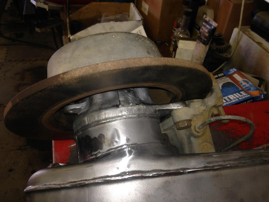

914GTSTI   A little more work on the Boxster to 108 axle. I...   Feb 9 2015, 02:06 PM
914GTSTI   Well you will need a spacer. I forgot the castle n...   Feb 9 2015, 05:35 PM

914GTSTI   All installed. 930 CV, cut Boxster Hub, and a 108 ...   Feb 16 2015, 12:44 PM
