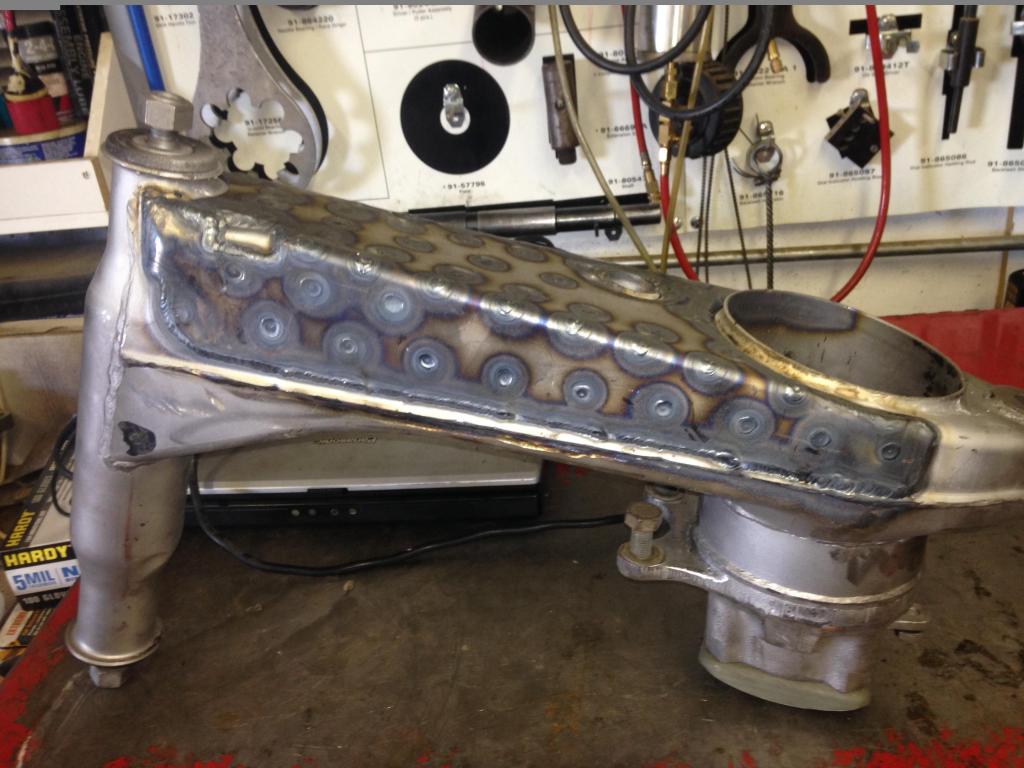

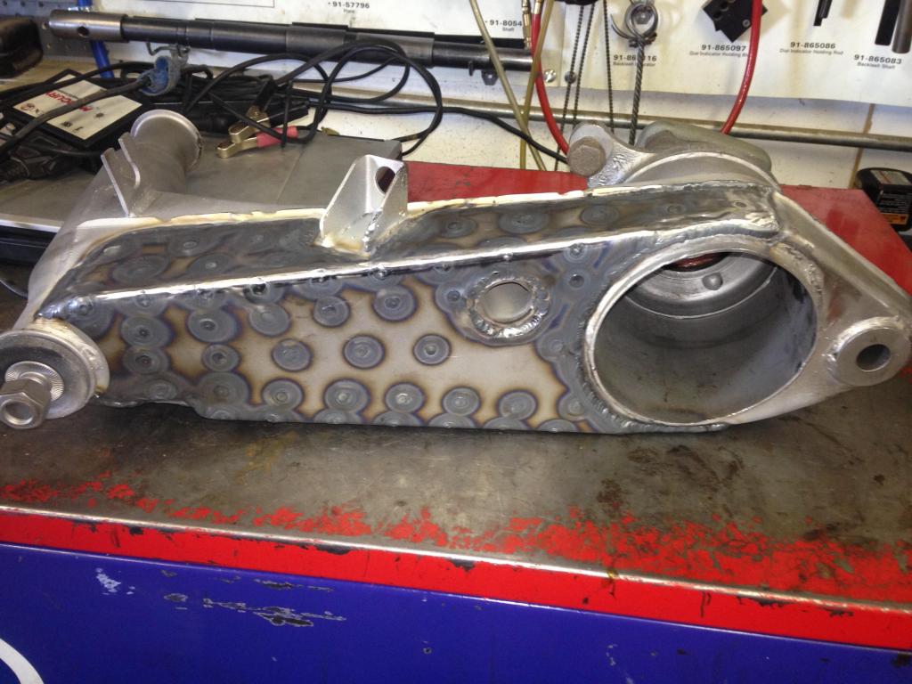

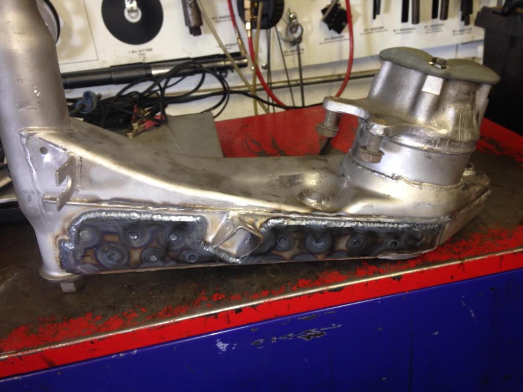

Yes I will use my mill.
I now have one stiffie ! (IMG:style_emoticons/default/lol-2.gif)
(IMG:http://www.914world.com/bbs2/uploads_offsite/i257.photobucket.com-8123-1423701127.1.jpg)
(IMG:http://www.914world.com/bbs2/uploads_offsite/i257.photobucket.com-8123-1423701127.2.jpg)
(IMG:http://www.914world.com/bbs2/uploads_offsite/i257.photobucket.com-8123-1423701127.3.jpg)
Just need to weld the end.
Is their good way to pull the bushing ? And replace it with rubber or ??. Will be going some track and fast driving.
Thanks, Randy
