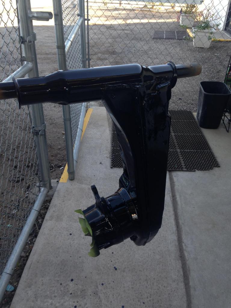

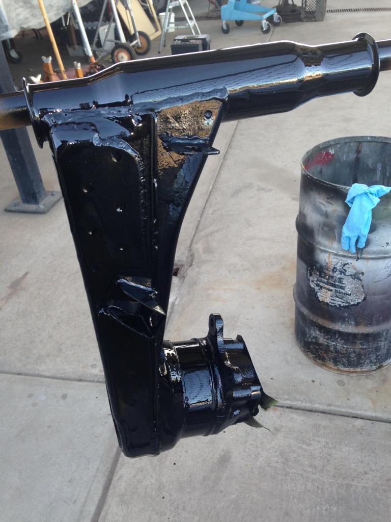

914GTSTI   I now have 5x130 and a parking brake ! :Qarl:...   Feb 11 2015, 12:40 PM

914GTSTI   Looking at the rotor shield and found some crackin...   Feb 14 2015, 12:56 PM
914GTSTI   I was doing some welding and I saw this on the ben...   Feb 14 2015, 02:35 PM
914GTSTI   All installed. 930 CV, cut Boxster Hub, and a 108 ...   Feb 16 2015, 12:44 PM
914GTSTI   Cleaned up the front cross bar and added some pain...   Feb 18 2015, 12:10 PM
914GTSTI   I know the manual said to drive out the bearing an...   Feb 18 2015, 05:12 PM
914GTSTI   Installed the crossbar and found the 11/1971 and t...   Feb 19 2015, 07:38 PM
