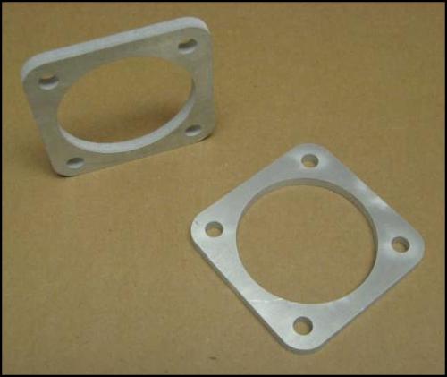

914GTSTI   I ordered in some Box outer hubs. http://www.914wo...   Feb 3 2015, 01:26 PM
914GTSTI   Here is a little add to using the Boxster hub. I m...   Feb 10 2015, 12:43 PM

914GTSTI   Huston we have launch ! It will work,but it ta...   Feb 11 2015, 12:33 PM
Jeff Hail   Order 4 911 rear bearing covers so they are double...   Feb 12 2015, 01:18 AM
914GTSTI   Here is what I found. The 911 flange is .090 thic...   Feb 12 2015, 10:41 AM
Mueller   Did you measure the wheel mating surface compared ...   Feb 12 2015, 10:57 AM
914GTSTI   The way I looked at it, the brake caliper is in th...   Feb 12 2015, 11:03 AM
Mueller   The way I looked at it, the brake caliper is in t...   Feb 12 2015, 11:06 AM
914GTSTI   No Problem ! All it takes is tools,parts,time...   Feb 12 2015, 11:28 AM
pete000   Might this be an option for the flange hitting the...   Feb 12 2015, 12:24 PM
914GTSTI   Yes this will work but may need to be chamfered ?   Feb 12 2015, 12:36 PM
Amenson   I got in touch with Chris Foley today and the diam...   Feb 12 2015, 09:25 PM
914GTSTI   Scott. The retainers from my Boxster hubs will not...   Feb 12 2015, 10:53 PM
Amenson   Scott. The retainers from my Boxster hubs will no...   Feb 13 2015, 06:59 AM
914GTSTI   It mite be open enough . When I get to the shop I ...   Feb 13 2015, 08:28 AM
914GTSTI   The Box center hole is 2.72" +-. The 914-4 is...   Feb 13 2015, 11:45 AM
914GTSTI   All installed. 930 CV, cut Boxster Hub, and a 108 ...   Feb 16 2015, 12:43 PM
