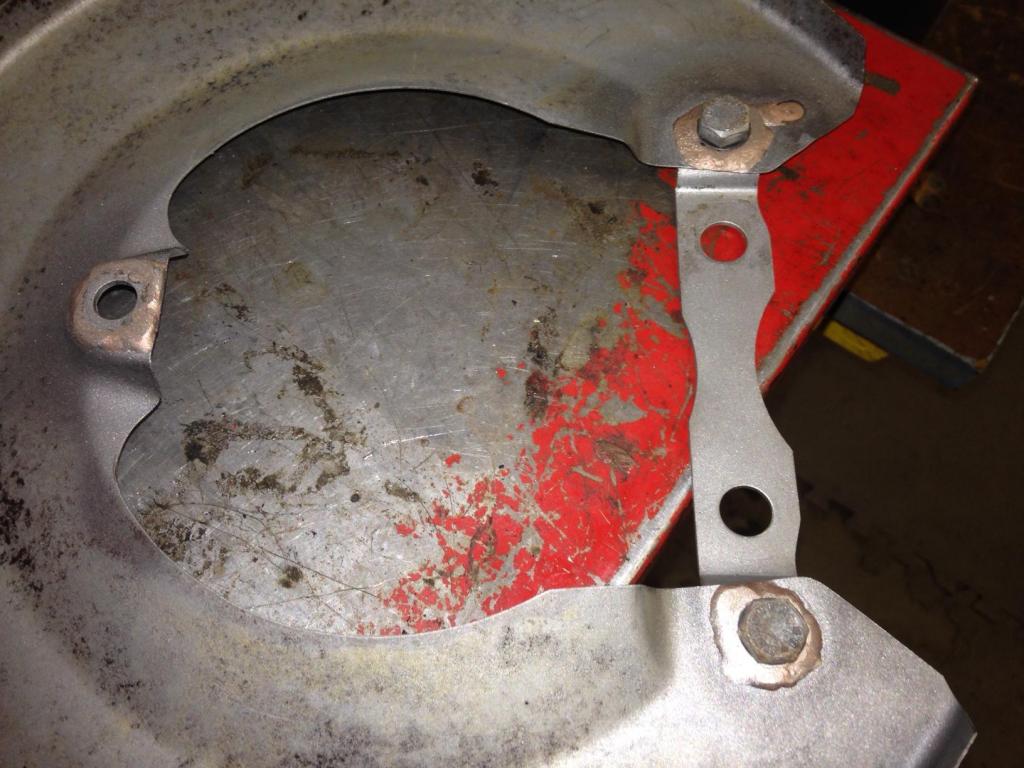

Looking at the rotor shield and found some cracking at the mounting holes. So I brazed some AN washers and should be go to go ?
(IMG:http://www.914world.com/bbs2/uploads_offsite/i916.photobucket.com-8123-1423940164.1.jpg)
Randy
