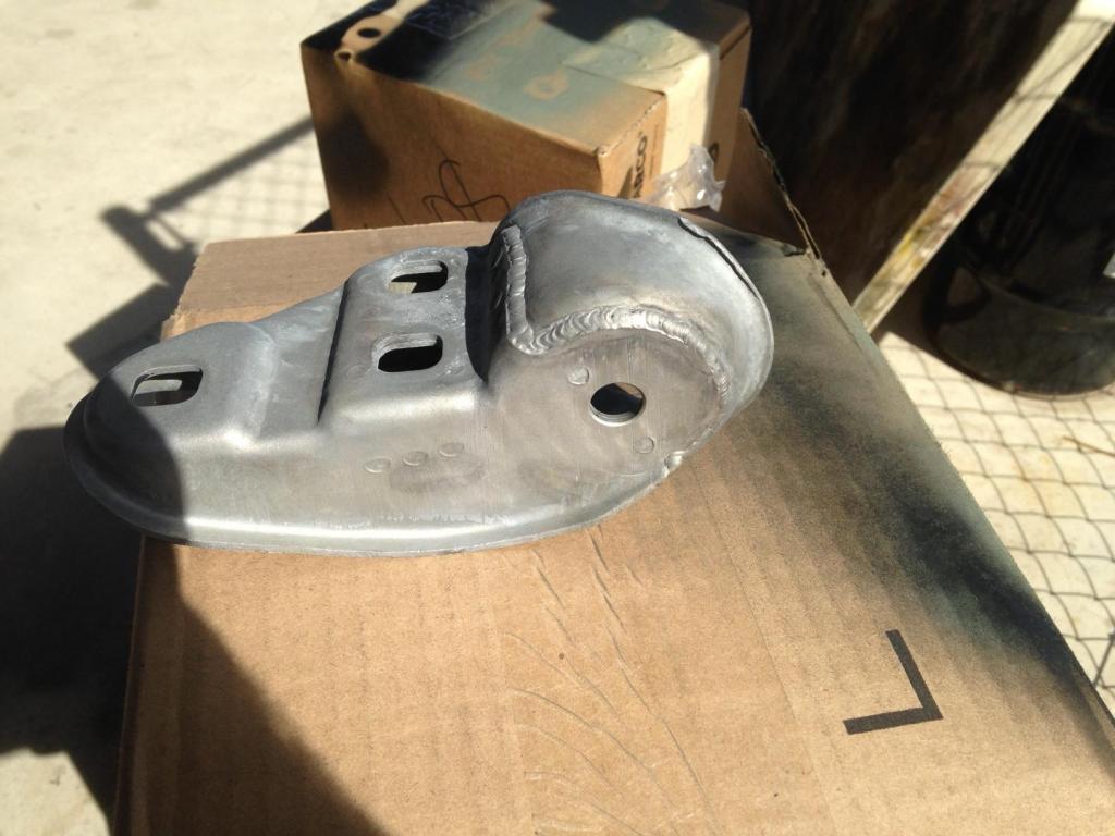

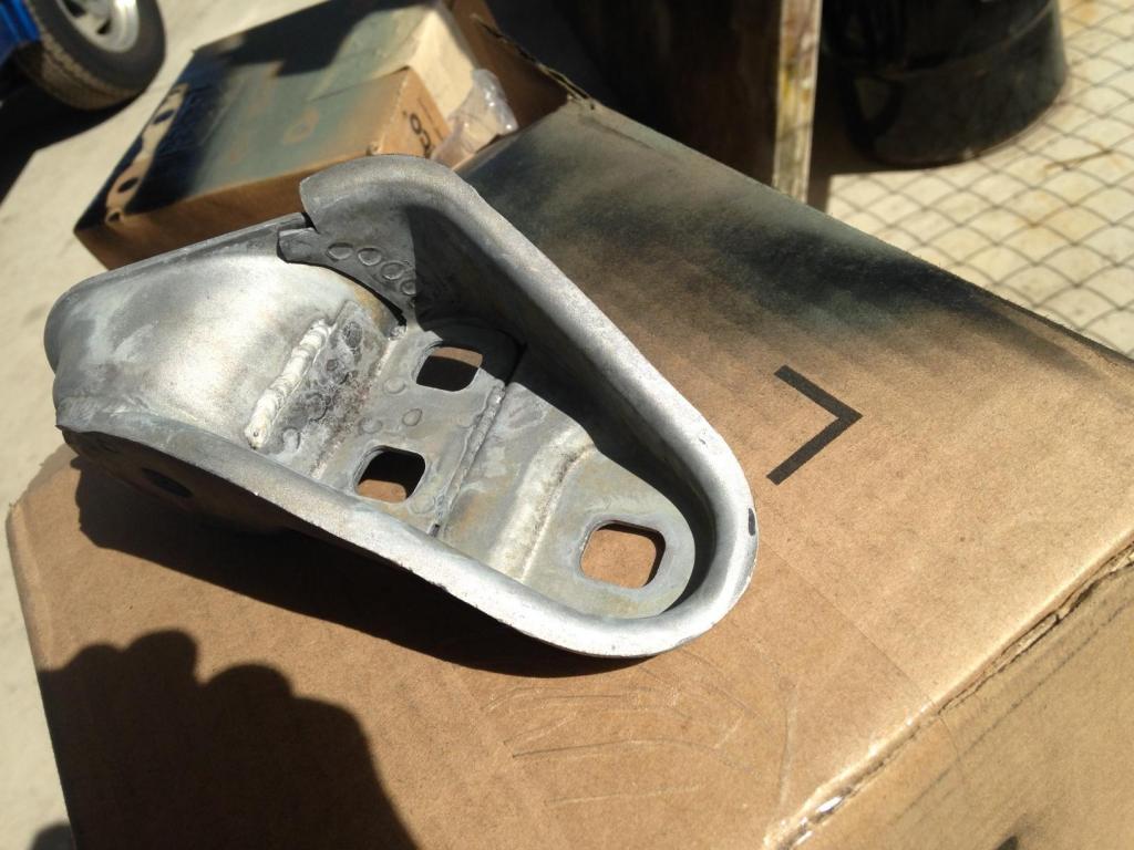

I was doing some welding and I saw this on the bench. So it got welded also. May not need it but ? (IMG:style_emoticons/default/idea.gif)

914GTSTI   Looking at the rotor shield and found some crackin...   Feb 14 2015, 12:56 PM
914GTSTI   I was doing some welding and I saw this on the ben...   Feb 14 2015, 02:35 PM
