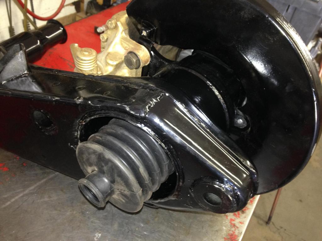

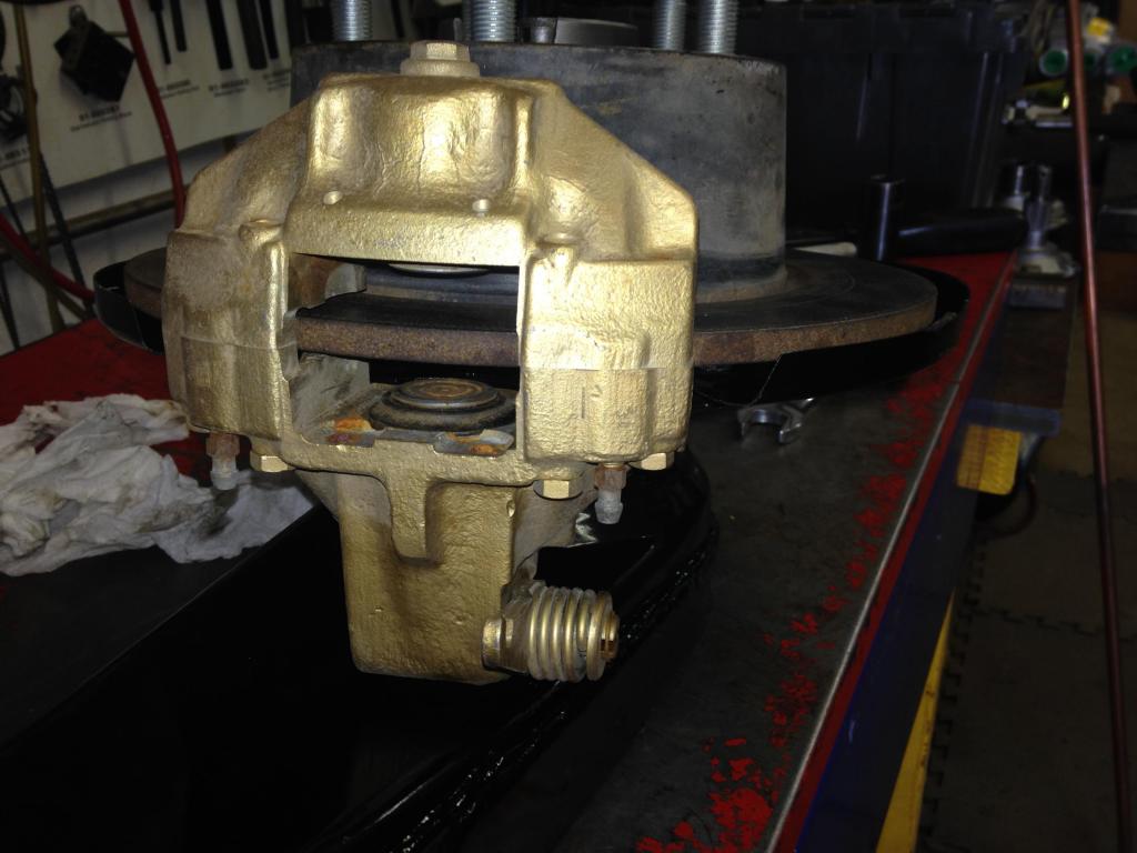

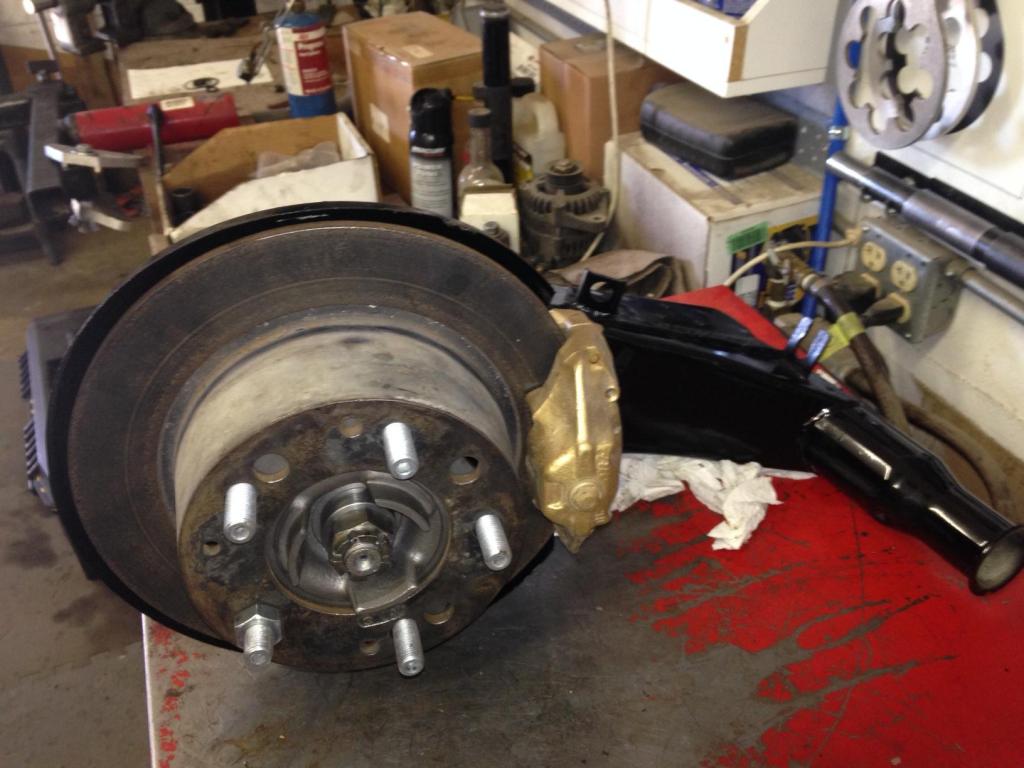

All installed. 930 CV, cut Boxster Hub, and a 108 MM stub. Stock brake caliper and rotor drilled 5x130.
(IMG:http://www.914world.com/bbs2/uploads_offsite/i916.photobucket.com-8123-1424112187.1.jpg)
(IMG:http://www.914world.com/bbs2/uploads_offsite/i916.photobucket.com-8123-1424112187.2.jpg)
(IMG:http://www.914world.com/bbs2/uploads_offsite/i916.photobucket.com-8123-1424112187.3.jpg)
Randy
