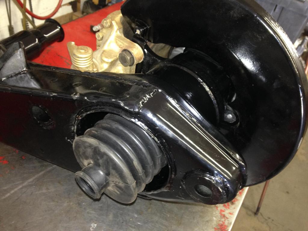

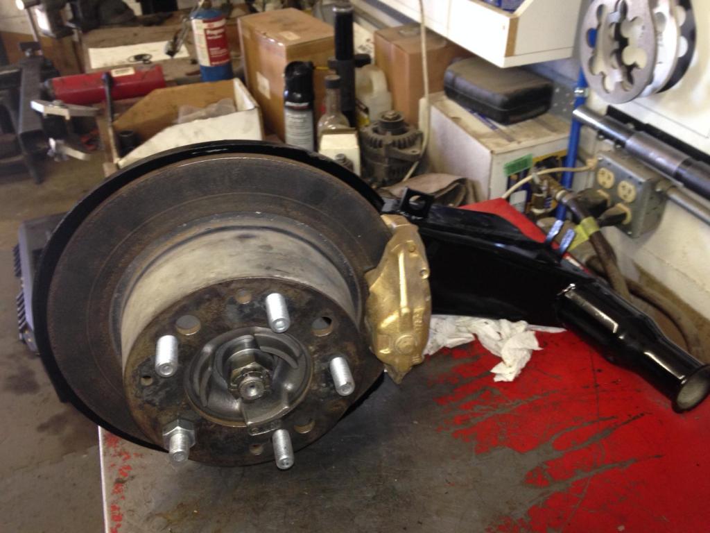

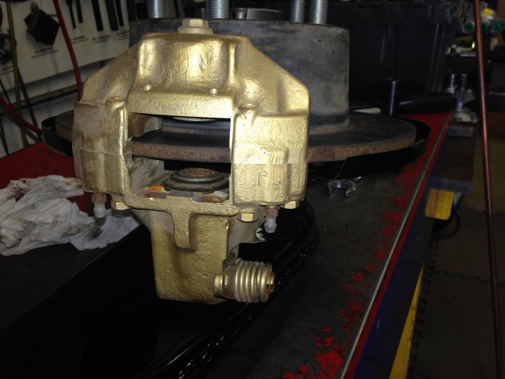

All installed. 930 CV, cut Boxster Hub, and a 108 MM stub. Stock brake caliper and rotor drilled 5x130.
