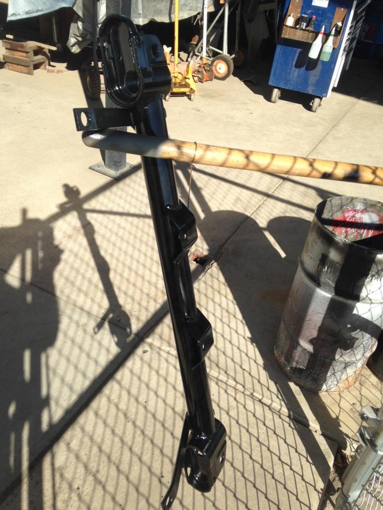

Cleaned up the front cross bar and added some paint.
