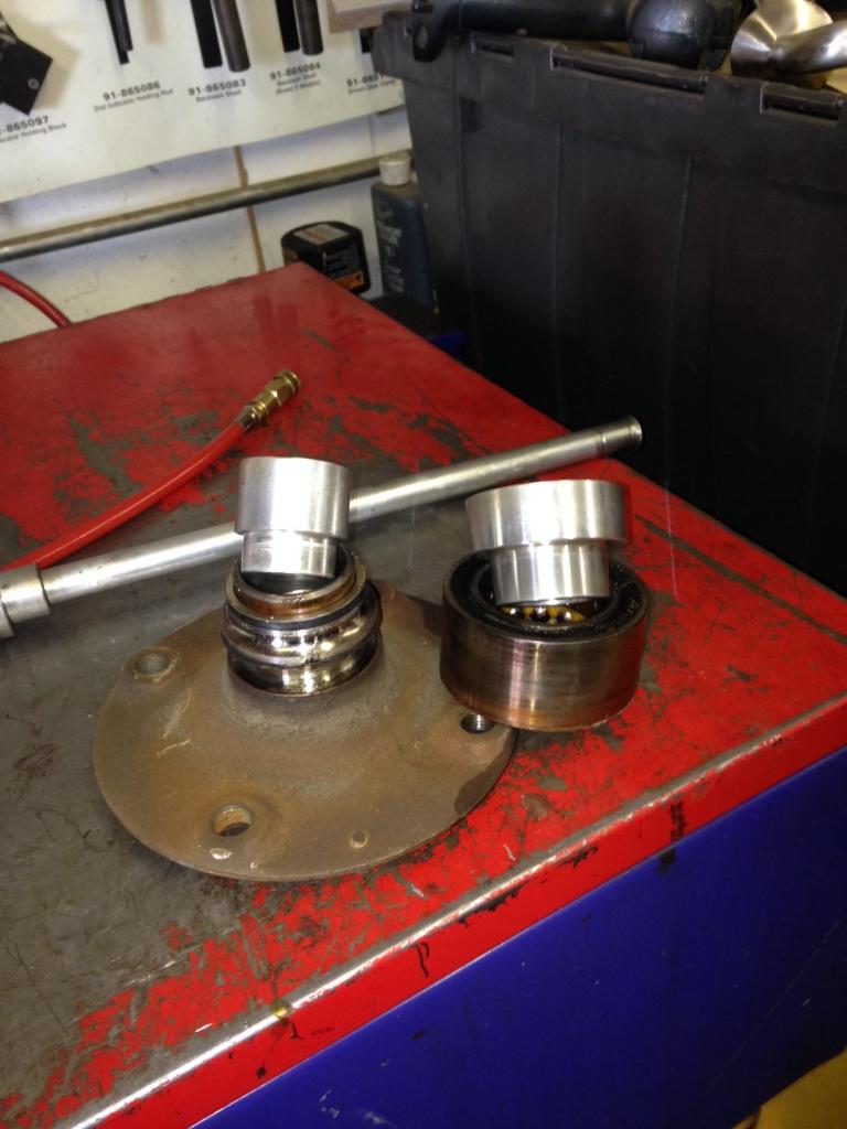

I know the manual said to drive out the bearing and the hub but it beats the hub a little. So I built 2 drivers.
(IMG:http://www.914world.com/bbs2/uploads_offsite/i916.photobucket.com-8123-1424301156.1.jpg)
